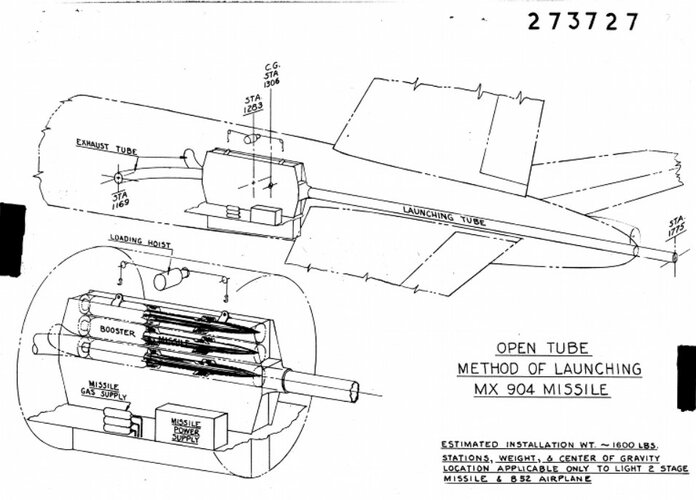

Haven't read anything about parasite fighters, but IIRC the Falcon missile family was originally intended to be a bomber defensive missile in the tail. Not sure if that was for the B-36 or B-52, though.
It was looked at with the MX-904 (the predicessor to the Falcon) but the only sketch I've seen attributes it to the B-52. According to Boeing B-52 Stratofortress by Peter E. Davies, et al. there was a proposal at the very least to replace the tail gun with AIM-92 Stinger Missiles under a "Project Scorpion". I haven't been able to find reference to it outside of the book but if it is true I suspect it more than inspired some of the armament for Dale Brown's "Megafortress".
Edit: It's on Page 58
