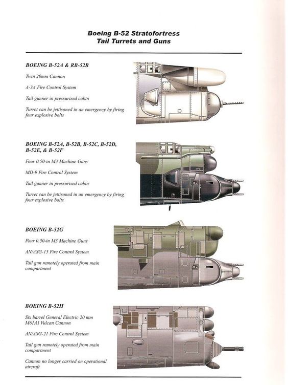

I wonder if it was for a wider dispersion of shot?
According to:
"The MD-5 FCS and twin-cannon installation was also adopted as standard equipment on the remaining 17 RB-52Bs and 16 B-52Bs ... However, this eventually proved to offer no real improvement by virtue of possessing more than its fair share of defects. In consequence, the last seven B-52Bs...reverted to the original armament package of four machine guns in conjunction with a version of the A-3A FCS that had supposedly been 'perfected'.

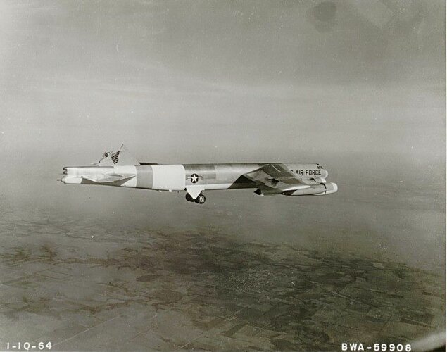

* In the B-52's early years excessive yaw had torn the vertical tail off several B-52s, with only one crew surviving, they managed to maintain control and land it! There have been a couple of recent airliner crashes where excessive side-forces on the vertical tail has broken it off the aircraft, resulting in an immediate crash.
The only B-52 to survive vertical tail failure:
