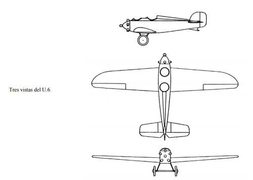

Udet

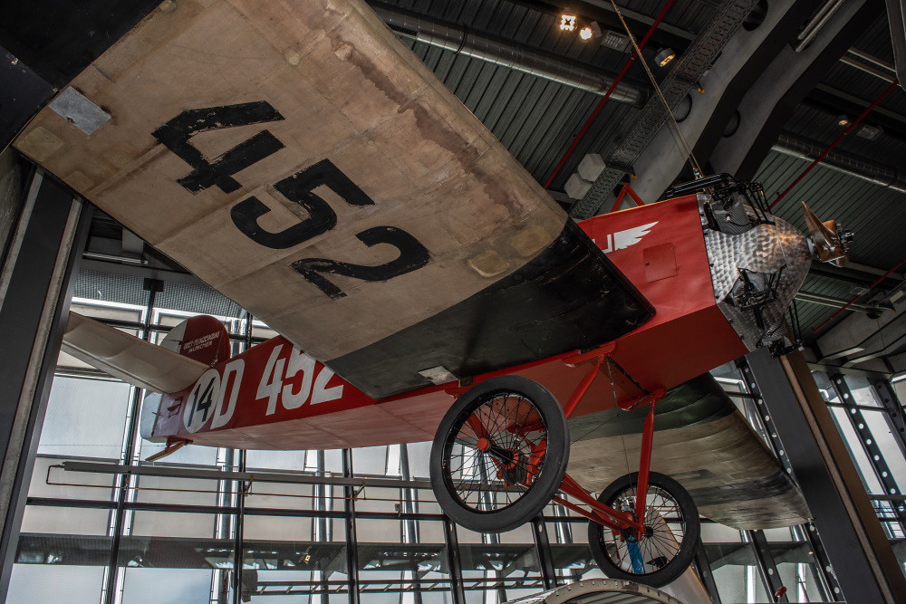

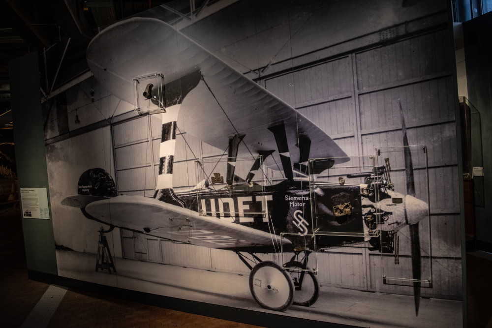

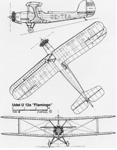

I don't know if these are of interest to your search for information on Udet projects, Hesham, these pictures were taken at the Deutsches Technicmuseum in Berlin. This is the Udet U 10 two-seat monoplane.
Udet U 10
The U 12 Flamingo D 822, seen in the big photograph in the background was the aircraft in which Ernst Udet flew spectacular aerobatic routines around Germany, which in part helped financially rescue the ailing firm in selling the U 12. D 822 was on display in the Third Reich's aviation museum the Deutsches Luftfahrt Sammlung located next to the Lehrter Bahnhof, now the Berlin Hauptbahnhof, just across the Moltkebrucke from the Reichstag. In the picture below you can see a mock up of the museum built in Poland, with the U 12 being the red and silver biplane at bottom right numbered 112. The museum was tragically burned out during a night bombing raid on Berlin in 1943 and the majority of the aircraft within were destroyed (although a handful survive!). Needless to say, the RAF contingent was not allowed back to the museum.
DLS Udet
The picture of D 822 with surviving bits mounted against it. It did not survive the fire.
Udet U 12
