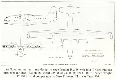

The picture of the 4-engined design is identical to that, of the Supermarine
524 in Tony Buttlers BSP, but there engines are said to be Proteus . ???
The 4 engine flying boat is the Saunders-Roe P.162 designed to Specification R.2/48 powered by either compounded Griffons or Turbo Griffons. From "Aircraft for the Royal Air Force" by Michael J.F. Bowyer ISBN 0-571-11515-2.

here is the 3-view about Supermarine Type-524.

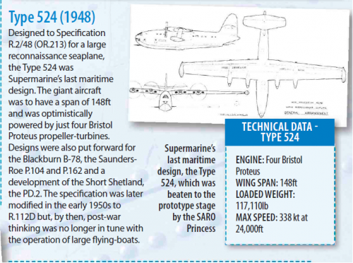

Where have you found this Supermarine info Hesham..?
My dear Lark,
the Aeroplane Monthly,Supermarine the Company Profile.
And before that, the Putnam book, from which they simply copied the artwork and information.
