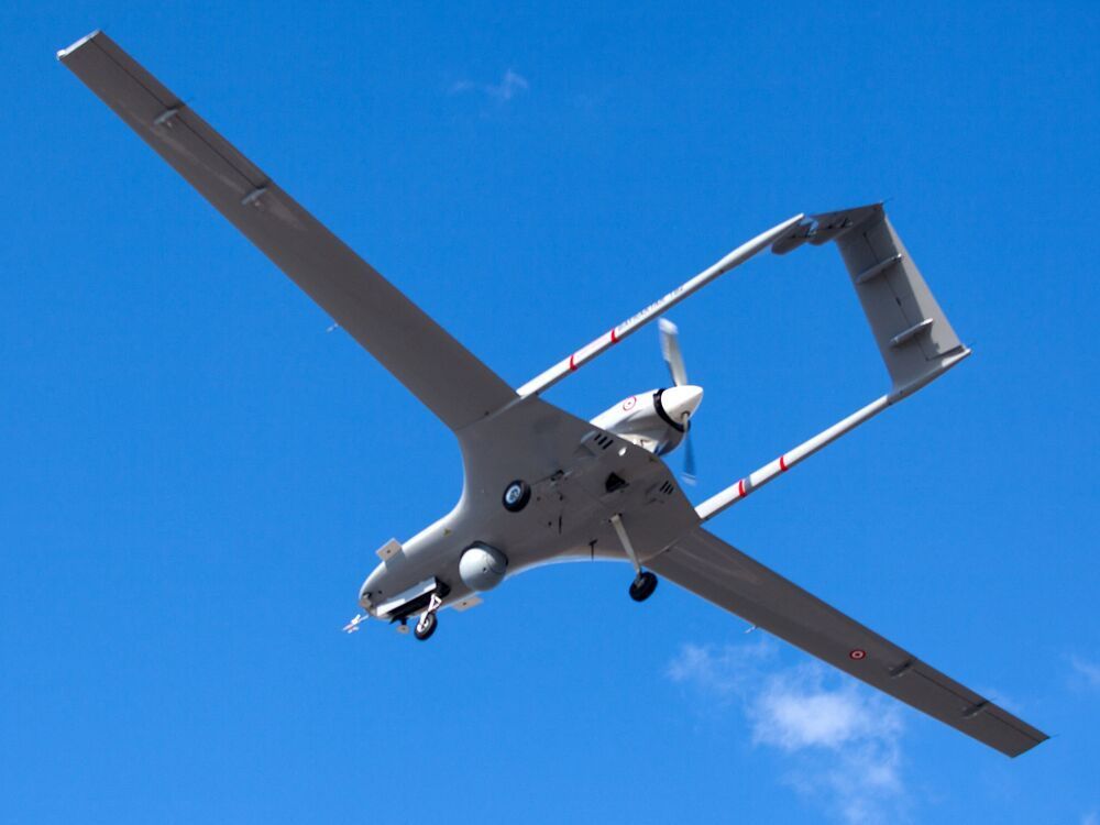

TB2 have for some time been produced without the Wescam sensors, no? I read that Argos-II sensor has replaced them on more recent airframes.
Turkmenistan is the only country that operates TB2 with S.African Hensoldt Argos-II E/O
The base E/O of the TB2 is now Turkey's Aselsan CATS.
I'm trying to find some data on CATS but the brochures are fairly slim. One mentions laser designator range up to 30 km, other says overall range of CATS up to 25 km.
Now those may be vague figures that understate real capabilities. Or they pertain to classification range, but not detection range. But if they're not - then Argos II beats those figures by a lot. I found a quite detailed article on Argos II showing both thermal and visual channel detection range, in good visibility conditions, against a pickup truck sized target to be 50 km.
Certainly, with a 40 cm inch diameter - the wescam, argos and CATS EO balls could, in theory where they reach same technology level one day, have similar capabilities as sensors inside Sniper targeting pods - as those feature same 40 cm diameter EO balls.
All brochures on the Aselsan CATS are out-dated.
I don't understand your performance comparison between laser designator range and visual range.

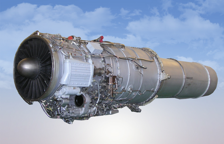

With the ongoing conflict in Ukraine, wont the supply of Ivchenko AI-25TLT engines be a problem ? Is there an alternative powerplant being considered for this project ?
Nothing has been shared regarding alternatives.
There were rumours of an indigenous engine being developed in the same class, but the rumours are heavily based on patent filings with nothing substantial to back it up.

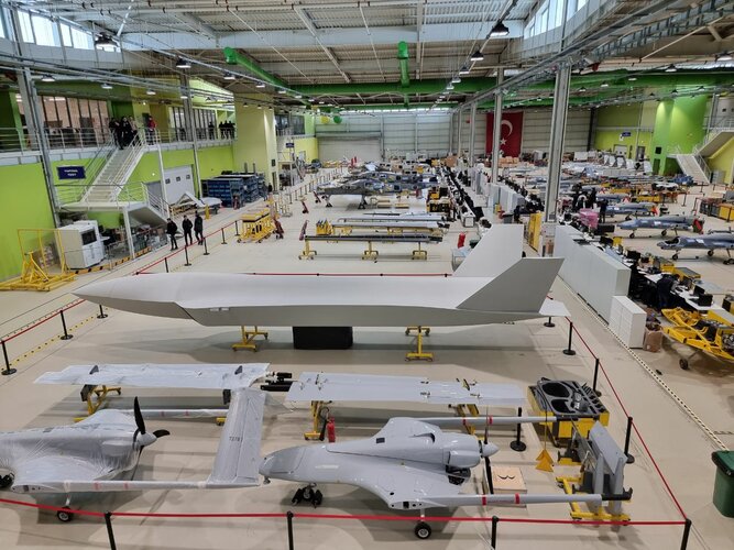

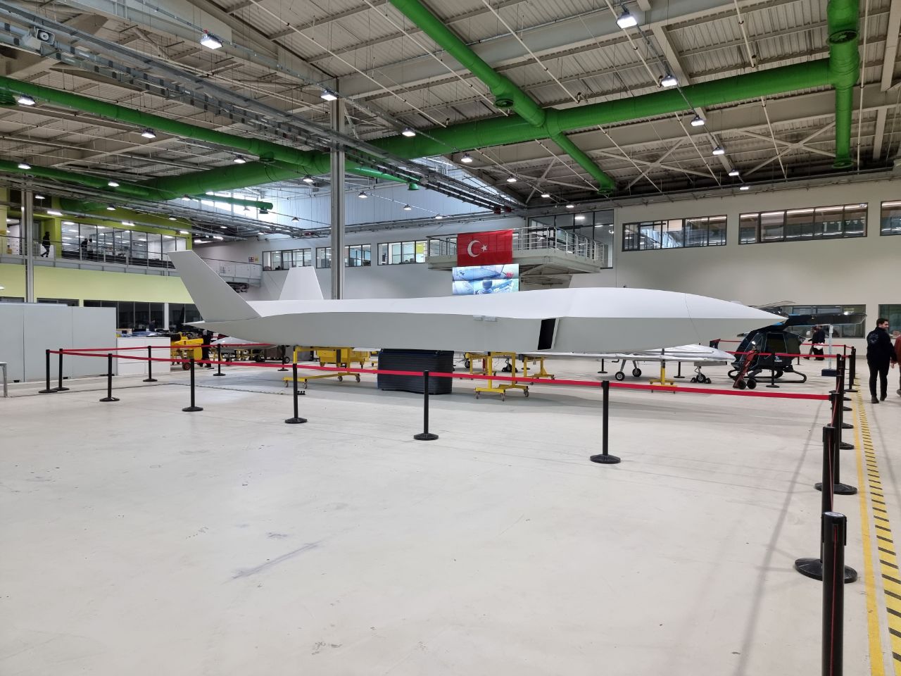

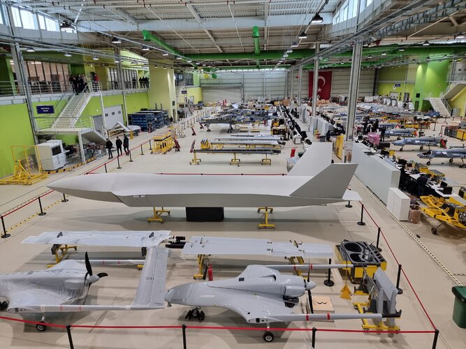

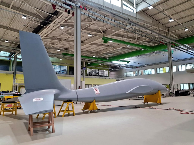

Well?!! That's a mock up only?
"A larger and more agile fish entered the production line 3 and a half years later.
MIUS - Unmanned Fighter Aircraft:
It's on the way, stay tuned.."
View: https://twitter.com/Selcuk/status/1502606947295674369?s=20&t=7bKorod7DB5wpRD2COS8wQ
Name of this aircraft is Bayraktar Kızılelma (Red Apple)
In Turkic mythology. Red apple represents an ideal or a goal Turkic people strive to reach but the closer you get the further it runs away so in reality you will never reach it
You can also see the TB-2 and Akinci production is at full tilt.
It's not a mock-up, this is the first prototype. Composite aircraft aren't built traditionally, access points and panels are cut out after.
Further confirmed by the BaykarTech Head of Technology;
View: https://www.youtube.com/watch?v=dt21E8tjO6E
Just like first Akinci PT-1 prototype;

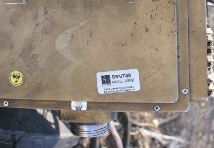

22 days into the Ukraine-Russia war, first confirmed loss of a TB2 emerges.
View: https://twitter.com/RALee85/status/1504378850347732994?s=20&t=QfAADsn4JcUjJtflr52Avg

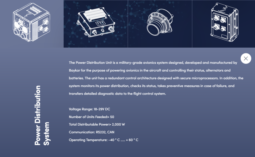

There seems to be a quality control issue, the sticker attached reads "Remove this sticker when the unit is connected to the Aircraft."
A technician at BaykarTech was not doing his duties properly, since the sticker is still attached.
Identified to be power distribution system
