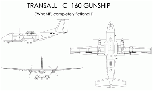

"..turining any of the C-160's into a gunship platform like the AC-130?"
Nice idea, never heard of it and actually can't remember any such gunship,
that isn't of US origin (Is there any ?) ! So we have to create it on our own ! ;)
Fixed armament similar tom the AC-130 with a 20 to 25mm gatling and a 105mm
howitzer and, as air superiority is essential in any way, pylons for 4 GBUs under
the wing and the ability to self-designate using the targeting pod attached to the
right sponson. Then let's just add a FLIR turret under the nose, spherical observation
windows in the fuselage sides and in the ramp, which carries a launcher for flares, too,
and some additional measures for self defence (ECM pods at the wingtips and the fin and
chaff/flare launchers at the rear fuselage) and, voila, here's our Taliban Nightmare ! ;D
Sorry for that, I'm not really a What-Iffer, but it would be great fun for me to see this design
to appear again on certain sites, as happened before, for example to my Breguet "Forteresse
Magnifique" ..
:D
Jemiba:
That is really cool, i think it would give the upcoming AC-27J a run for its money, just my thought! Thanks for the picture :)
