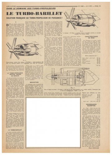

Dear Boys and Girls, here is an article in French about an unusual compound propulsion concept. The Turbo-Barillet uses the efflux from three small jet turbines (in this case the Armstrong-Siddeley Viper) to act jointly on a rear-mounted free turbine which powers a large diameter propellor through a normal reduction gearbox. The concept intends to show that compounding of small turbines can create a powerful propulsion system; the article shows that a triple-Viper unit can fit inside the same size engine cowling as a Pratt & Whitney R-2800 or R-4360 and would be shorter and lighter than a conventional turboprop engine (I think by implication a Turbo-Barillet could be a drop-in replacement for an existing piston engine). I do not know if this system was ever tested......
The article comes from the 6th July 1957 issue of Les Ailes......
