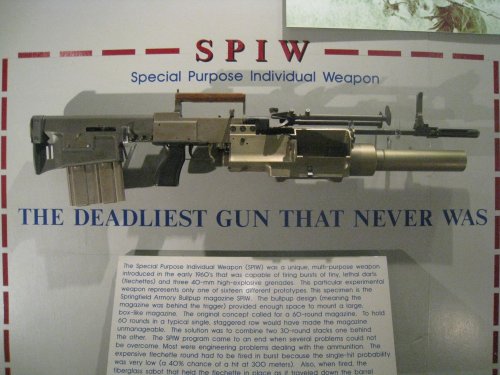

Unlikely. The TTX seems to date from the late 1970's, and by that point combined weapons had been around for quite a while, including the SPIW.

.50 caliber seems an odd choice... not different enough from the basic weapon to be of much utility...
