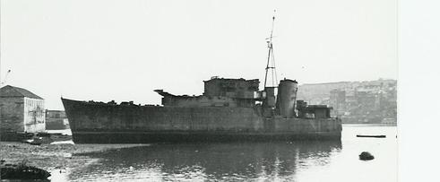

Fascinating topic. I read about these when I was a lot younger. I recall a story that two tribals were damaged and spliced in both world wars but frankly cannot find any reference now I am aware of Eskimo losing her bow in Narrvik but the rest is lost to fuzzy recollection. Were they Tribals in ww2 or am I thinking of another class of destroyer?

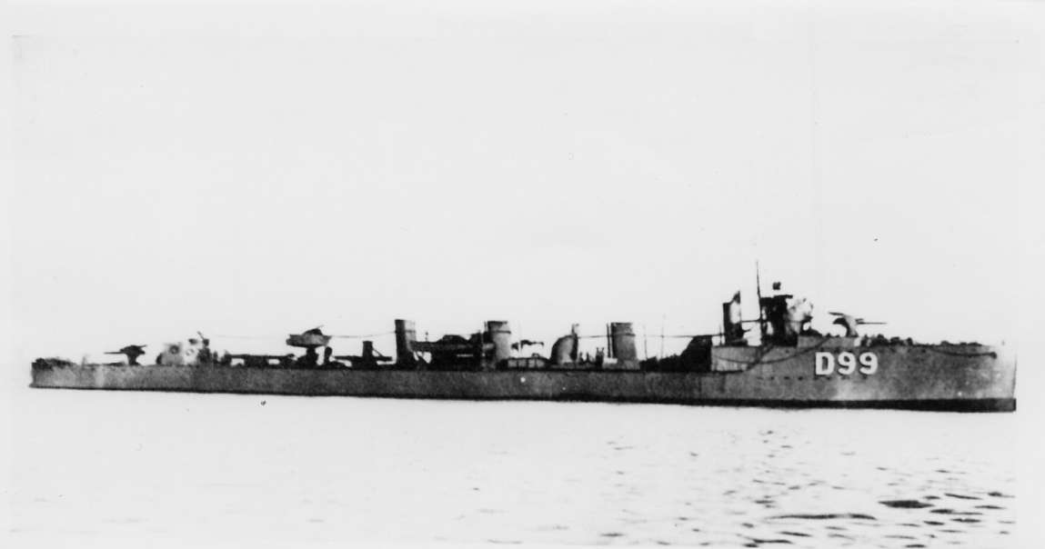

In WW1 both the Tribals Zulu & Nubian were torpedoed. The surviving parts were rejoined to form HMS Zubian.
Can’t think of a case in WW2 and it certainly wasn’t a Tribal. Many ships lost bows (like Eskimo in WW2) or sterns or both (Javelin in 1940, reduced in length from 353ft to 155ft or the cruiser Argonaut in Dec 1942) and had them rebuilt. Mostly happened early War when it was easier to rebuild to get numbers. Later they were just treated as irreparably damaged and written off.
Then there was HMS Porcupine. Torpedoed, she was w/o, cut in two and towed back to Britain where the halves became HMS Pork & HMS Pine.
Edit. And there were a few ships split in two that had their parts rejoined.
RFA Abbeydale for example from June 1943.
