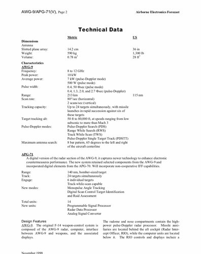

Radar:
F-14D is equipped with APG-71 slotted mechanical scanned radar. APG-71 can detect bomber size target (RCS = 100 m2) from 140 nm. So F-16 size target ( RCS= 1m2) will be detected from 44 nm.
F-16 block 60 is equipped with APG-80 active electronic scanned array radar. APG-80 can detect target with RCS =1m2 from 64 nm. So F-14 size target (RCS =10 m2) is detected from 114 nm.
APG-80 is smaller and weaker than APG-71 but F-16's RCS is much smaller than F-14D. Secondly, APG-80 was made 13 years later so it also have processing, software and threat library over APG-71. To sum up, F-16 block 60 can detect F-14D from twice the distance the later can detect it and APG-80 radar with irregular scan pattern and low side lobes will be more ECM resistance and with better LPI ability than APG-71 as well.

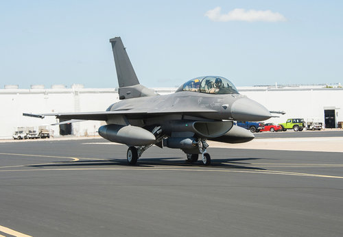

F-14D is equipped with AN/AAS-42 scanning array infrared system.
F-16 can be equipped with Legion pod, which is a modern staring array version of AAS-42 in a pod.
Staring array have better "scan rate" than scaning array, later system will be more sensitive and F-16 is physically smaller than F-14 so its IRST will track F-14 before the later can do the same.

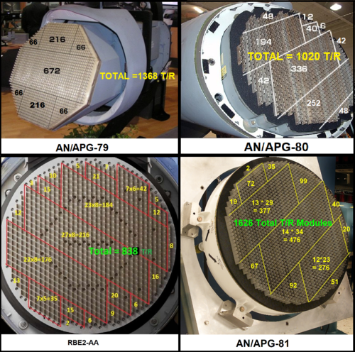

Thirdly, F-35 has superior track and engage range compare to Typhoon and Rafale because:
Radar:
APG-81 has 1626 T/R modules compared to 828 T/R modules of RBE-2AA and 1500 T/R modules of CAPTOR-E. More T/R modules is more output assuming the output of each T/R modules is similar. And more modules is bigger aperture which will improve gain, which in turn give radar more directivity and better detection distance.

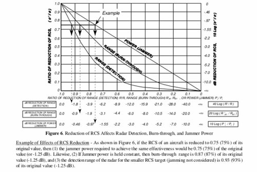

RCS:
No need to explain much, F-35 win hand down with RCS several order of magnitude smaller than Rafale and Typhoon.

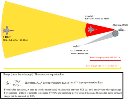

ECM: smaller RCS lead to much lower jamming power requirement (aka 1000 times lower power) and shorter burn through range
And F-35 has cognitive jamming

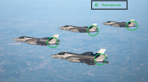

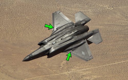

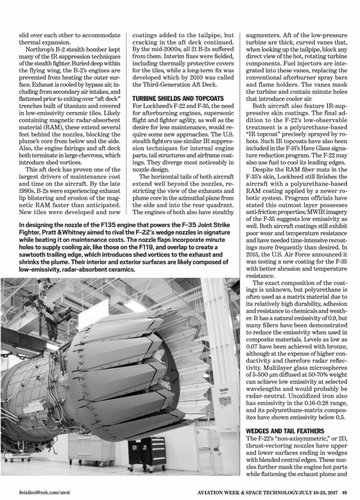

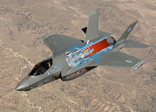

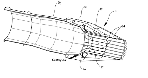

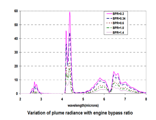

Infrared:
Clean Rafale and Eurofighter are smaller than F-35, and that is an advantage. But F-35 has many design choice to reduce its infrared signature
Cooled nozzle and turbine blocker:
Cooling vents for engine bay
Masked nozzle:
High bypass engine:
Infrared reduction paint

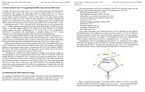

That's too big of an assumption tbh. Only thing that can be certainly told from TRM count is better hardware angular resolution.
If two radar operate in similar range of frequency, using T/R modules with the same out put, isn't it obviously that the one with more T/R modules have more total out put?
Problem is: you can't even remotely reliably suggest that they use TRMs with same output until you KNOW that as fact.
That is correct, I was assuming their T/Rs are with similar power rating for the sake of simplification like when people assume lift coefficient of two aircraft are the same when comparing wing loading. But what you said is true.

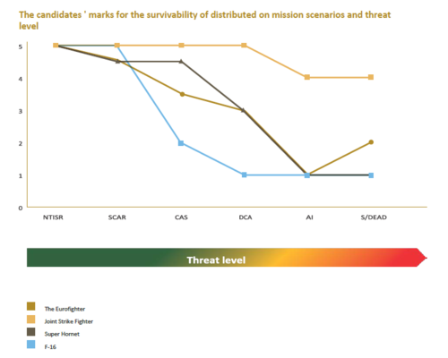

P/S: Denmark has an official government evaluation between Trance 3 Eurofighter , F-18 E/F, F-16 C/D and F-35
