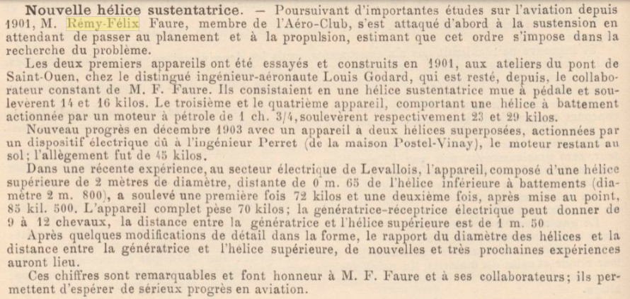

The following info on Rémy-Félix Faure, lifted off the February 1904 issue of French monthly L'Aérophile (p. 48), might be of interest.
A thought. Is it possible that the photos show the various stages of the work done by this gentleman?
yes exact
