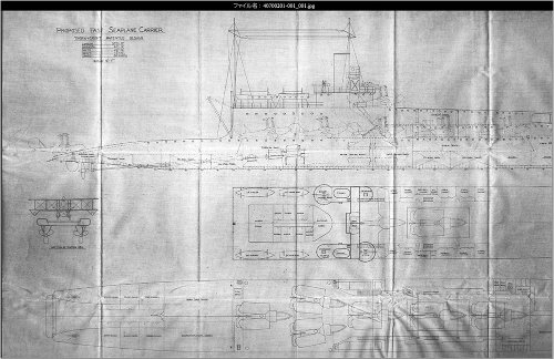

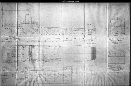

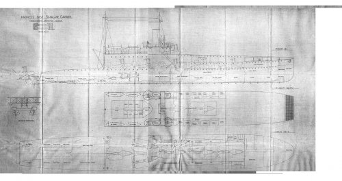

Not perfect I know, but I "stitched" the images together when I saved them to my PC from the same site.....
I would be very curious if anyone more knowledgeable had opinions about the feasibility and effectiveness of such a design.

I'm not certain, but I think the recovery system was tried on land and it had a tendency to damage the aircraft.
To my opinion, the sloping stern worked in a similar way, as the "Schleppsegel" (towed sail)
used on the German catapult ships (drawing via http://www.zeitreise-bb.de/boebl/boebl/luftp.htm)
An aircraft design taking-off and landing on water, but with only marginal buoyancy we had here
http://www.secretprojects.co.uk/forum/index.php/topic,9793.0/highlight,martin+328.html, maybe workable if shore based, but otherwise probably prone to a high attrition rate. But those
aircraft could have better performance, than pure flying boats, I think.
A hydroski arrangement on an othrewise conventional aircraft was tested on an Auster J5, see here:
http://www.photoship.co.uk/JAlbum%20Ships/Hovercrafts%20Flyingboats/
