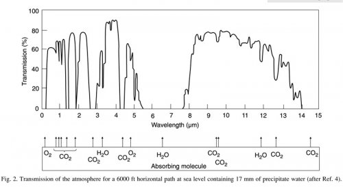

Consider this graph showing how IR transmissionin air varies with wavelength. Imagine you can tailor your IR emissions to the right wavelength... you can effectively defeat IR sensors.
