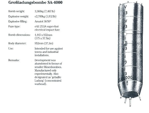

i once saw it in the german munitions and explosives document from the US army, i've wondered ever since what it exactly is and what happened with it?
it even get's mentioned on wikipedia.

We have an existing thread here: https://www.secretprojects.co.uk/th...m-storage-facility-stafford.10208/#post-95686
The thread title calls it a radiological (dirty bomb) but there's no evidence for that. It was to have been a large (4000-kg) thin-wall demolition bomb that never saw much if any use.

i made this thread because i didn't believe it is a dirty bomb, from what i read just a very big bomb.

On this site, we generally keep the conversation about one system in a single thread (or at least try to). If the subject line is wrong, it can be edited.
In this case, I think the conversation in that thread does a pretty good job of making it clear that it's probably not a radiological bomb.
It is what is classified as Luftmine. Just a bomb not intended to penetrate before explosion, but work only through blast. See:
SA-4000 is mentioned in German section.
