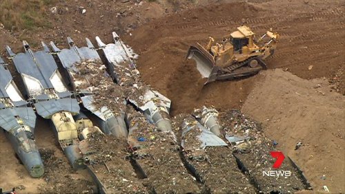

So ends the F-111 yesterday. Underground which is kind of ironic because of its TFR capability and Pig nickname. Snouts buried!

Gimme a break: why are they burying the airframes ? :eek: Don't tell me all that metal isn't worth a recycling... I'm sure the chinese would gladly turn those airframes into building or ships or razor blades...
It almost seems disrespectful - it also seems funny, because I'm here typing & feeling as if the burial needed a priest, casket, a stand of mourners, etc.
That said, tis a shame to see them go.
As a consolation: At least for future archaelogists it really may be a godsend !
They probably will interpret it as a sacrfice to archaic gods ... :-\
OK before the howls of indignation fuelled by a heavy dose of ignorance get out of hand here are a few facts.
Some 13 of the ex RAAF F-111s have gone to museums and the like. All ex F-111s except a few ‘special’ aircraft (ie RF-111s) were made available to charitable organisations who might have wanted them for public display. The catch was it costs about $1 million to remove all the asbestos and other hazards and demilitarise them to make them safe for public display. Without much surprise no one took the Aus. Govt. up on this ‘generous’ offer so the unfunded demil F-111s had to be disposed.
Shipping these aircraft back to the USA for reclamation at Davis-Monthan was too pricey so they were buried. Sending them to a third party for scrapping was against the conditions of sale. I’m sure China would have loved to get their hands on former USAF FB-111As… Whatever value is in their 500+ tonnes of aluminium is just not worth the effort of scrapping.
If you can’t dump them in the ocean or cut them up or bomb them on the range burying is an effective means of disposal. The thing I find most surprising is how shallow the hole looks. Zombie F-111s?
From what I understand, they are being used in a landfill site, so there will be lot more garbage put on top of them before a new ground level is obtained.
Unfortunately, burying them was the cheapest option....
