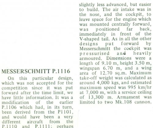

Hi Cars,
a more info about P.1116.

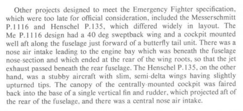

From the book; Secret Nazi Aircraft 1939 -1945 Luftwaffe's Advanced Aircraft Projects
here is anther info about P.1116.

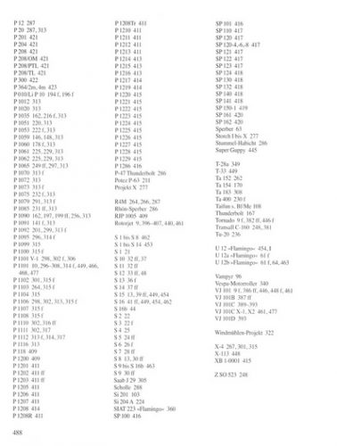

Hi Newsdeskdan,

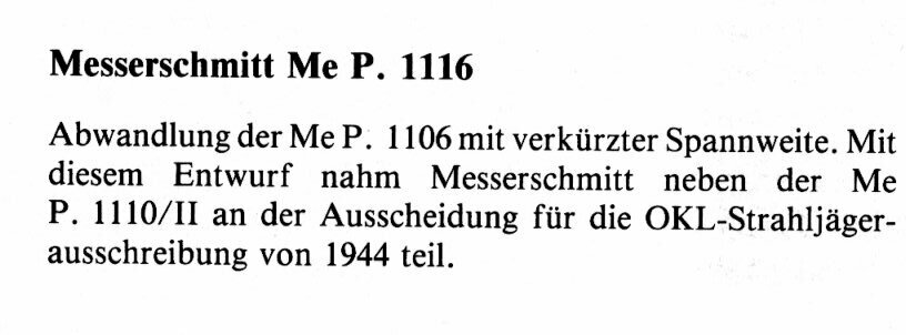

in the book; Willy Messerschmitt. Pionier der Luftfahrt und des Leichtbaues,they
spoke about Messerschmitt P.1116,I don't have the book,but I saw a page of index
of it on Internet ?.

Okay, interesting. I'd love to know what it says... although the lack of a P.1113, P.1114 and P.1115 on that list doesn't bode too well.
Had a look into "Messerschmitt Geheimprojekte" by Willy Radinger and Walter Schick: Yes, they actually mention
the P.1116, but as "make-believes by some authors" only. The development of the P.1111/1112 is listed in
chronological order, with the date of the last, final design of the P.1112 ("Zeichnung XVIII/166 P1112-V1") finished
on the 30th of March 1945 and the description of the mock-up on th 18th of April 1945. So there wouldn't have been
much time to produce a new design, I think.

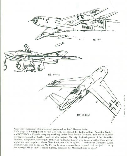

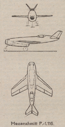

From Ailes 15/8/1953,
they claimed wrong it was Me P.1116.

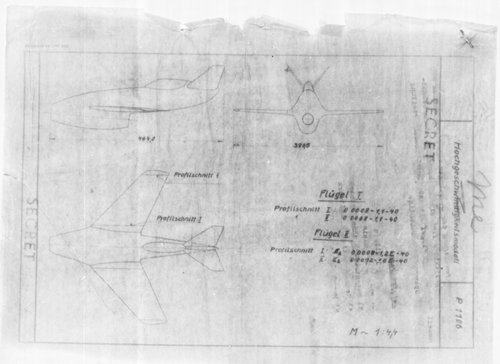

From Messerschmitt AG circa December 1944,
I'll say it again: There is no P 1116 - that's just an inaccurately drawn and inaccurately labelled picture of the P 1106, which was Messerschmitt's sole entry for the 1-TL-Jaeger competition at the design comparison meeting of December 19-21, 1944. If any mods are reading this, can we move 'Messerschmitt P.1116' to speculative please? There is no historical basis for it.
