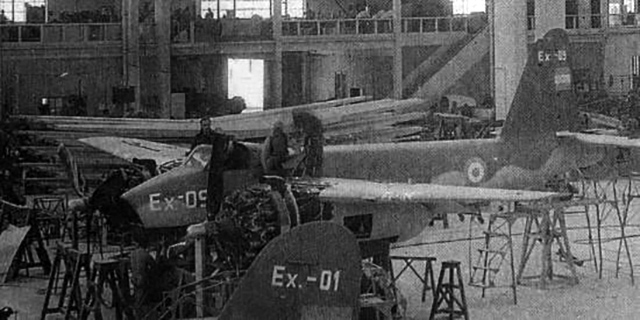

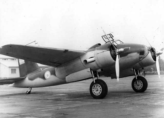

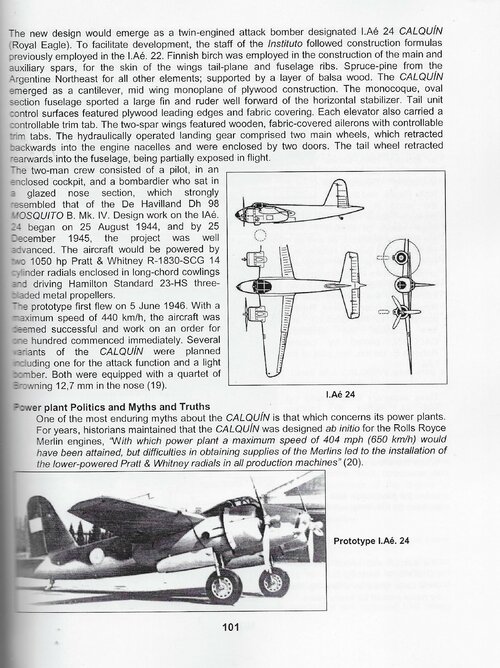

The I.Ae 24 Calquin (Royal Eagle) aka Abro Escalafón
(from my book on Argentina's Fábrica Militar de Aviones)

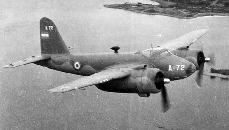

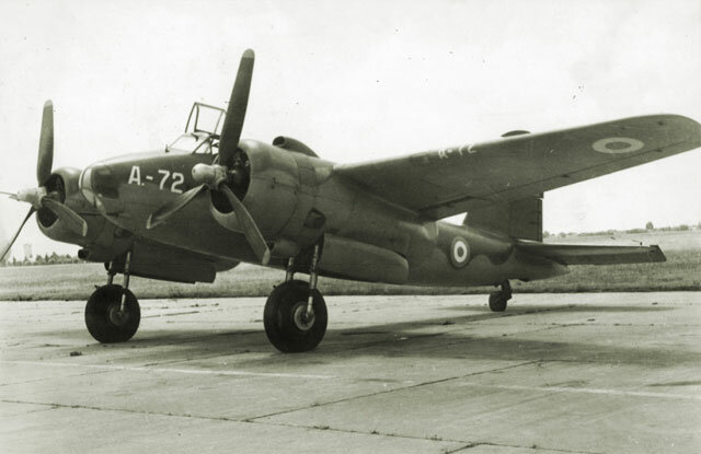

I.Ae.24 of the Argentine Air Force, carrying the serial "A-72" (Photo: Via the author.)

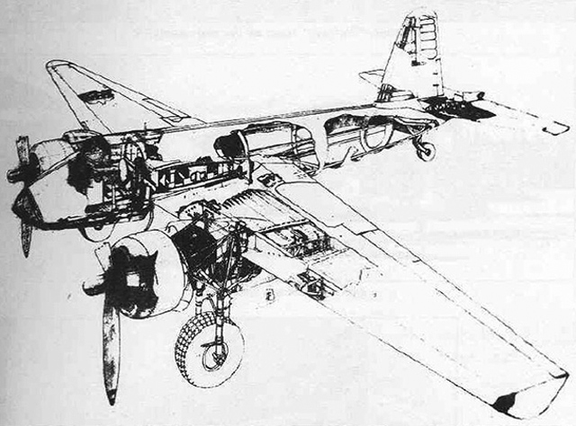

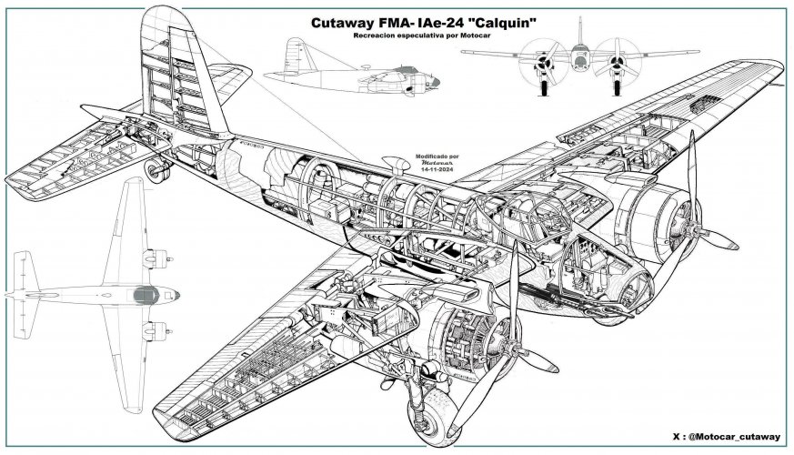

Cut away drawing of the I.Ae.24 Calquín. (Image: Via the author.)
The I.Ae.24 Calquín was a twin-engine, mid-wig, two-seat airplane designed primarily for ground attack missions. Due to scarcity of raw materials right after the end of the Second World War, it was decided that the Calquín was to be built using native woods, following the already proven techniques used for producing the renowned I.Ae.22 DL trainer. Its landing gear was retractable and folded backwards into the engine nacelles, becoming completely enclosed by integral wheel covers. It had a retractable rear wheel in the tail section. All three landing gears were equipped with pneumatic-oil shock absorbers.

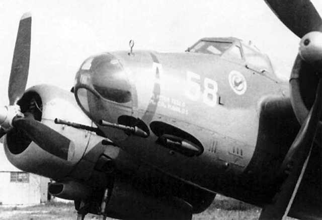

Excellent study of the nose section and placement of the Browning 12.7 mm machine guns installed in the I.Ae.24 serial A-58. (Photo: Via the author.)

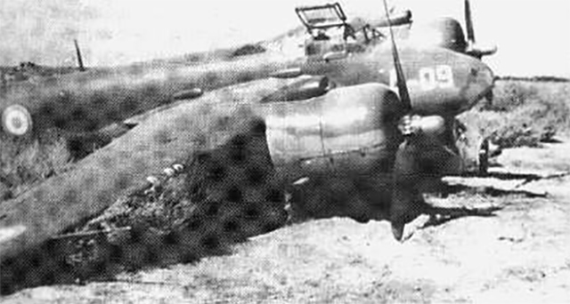

The accident record of the Calquín is well known. However, some times quick conclusions are drawn from cold statistical data. We are not saying that the I.Ae.24 was an “easy to fly” aircraft, nor that it had “noble” flying characteristics and was kind to the rookie pilots. In fact, its handling had been somewhat compromised by the replacement of its engines during the design phase. However, we will say that the great majority of accidents in which the airplane was involved, also involved young pilots or pilots with limited experience. According to Jorge Conan Doyle, an FMA test-pilot who amassed around 3000 hours in the Calquín, to fly the airplane it was necessary “…to have experience. But I took it by the hand, and I never had any problems. It was unstable on its three axis, it crossed its controls, and inverted easily.” (Quoted from the article of Ricardo Burzaco published in the November – December 1997 issue of Aeroespacio Magazine.) As it can easily be seen, Conan Doyle did not have any major problems with the airplane, but he acknowledges that flying it required careful handling.
The aftermath of a runway excursion. I.Ae.24 serial A-09. (Photo: Via the author.)
In any case, its reputation as being “a little untrustworthy” played against the Calquín and even the slightest of incidents was considered by the pilots to be enough reason to declare an emergency. In this case, the antithesis to demonstrate against the bad reputation of the aircraft was represented by the then Captain Carlos Bergaglio, who could perform a series of aerobatic maneuvers and land and roll down to a full stop, with both engines stopped, a ’la Bob Hoover.

It was a dangerous aircraft, by any measure, and accidents were continuous. In 1958, the 23 remaining in operational condition were suffering from structural failure and stricken off the inventory. On the other hand, the I.A.é 22 was quite a plane and well-liked by pilots who considered it superior to the North American NA 16.

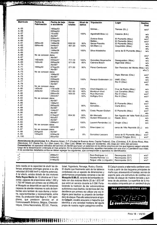

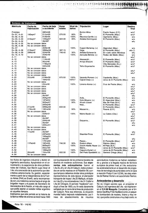

Now let us review the operational history of the Calquins, which were given serial numbers A-01-A-100 :
W.O.= Written Off, S.O.C. =Stricken off charge.
A-01 w.o. 3/51
A-02 w.o. 3/52
A-03 w.o. 3/57
A-09 w.o. 3/51
ex-06-w.o. 4/48
A-010 w.o. 6-48
A-012 w.o. 4/49
A-013 w,o, 11/52
A-16 wo.. 12/49
A-19 w.o.4/49
A-020 w,o, 3/58
A-21 w.o. 3/58-two crewman killed.
A-23 w.o. 7/48 two crewman killed.
A-30 w.o. 4/52-two crewman killed.
A-31 w.o. 9/57., when it crashed against A-050.
A-33 w.o. 5/58
A-36 w.o. 3/51, two crewman killed.
A-39 s.o.c. 4/49-Note those aircraft marked as s.o.c. had suffered accidents and were beyond repair
A-040-s.o.c. 11/51
A-46-s.o.c. 4/1950
A-49 s.o.c. 9/55
A-50 w.o. 3/51 two crewman killed.
Calquin: w.o . and s.o.c:
2nd Part
A-051 w o after accident-(hereafter a.a.) 5/52.
A-52-w.o. 5/50-two crewman killed.
A-53w.o.5/53 two crewman killed.
A-54 w.o.3/51
A-55 s.o.c. a.a. 9/53
A-56 soc 9/53
A-57 w/o. 7/52 two crewman killed.
A-59 s.o.c 11/51 a.a.
A-60 s.o..c. 9/49
A-61 s.o.c. 3/58
A-64 w.o.3/56A-61 s9.
A-63 w.o.7/53
A-64 w.o. 3/56
A-65-w.o. 1/53
A.66 s.o.c. 5/58.
A-69 w.o. 9/56
A-71 w.o. 8/55
A-72 s.o.c. 12/57
A-73 s.o.c. 3/52
A-76 w.o. 9/55
A-77 s.o.c. 1/53
A-79 w.o. 4/52
A-80 w,o, 1/58 two crewman killed.
A-82 w.o. 5/53.
A-83.s.o.c. 1/57
A-84 s.o.c. 7/53
A-86 w.o. 5/58
A-89 s.o.c. 4/57
A-90- s.o.c. 1/56
A-91 w.o. 9/57
A.93 w.o. 3/51 two crewman killed.
A-96 w.o. 10/45 two crewman killed.
A-97 s/o/c/ 5/57
A-99 s.o.c. 11/56
A-100 s.o.c. 6/52
