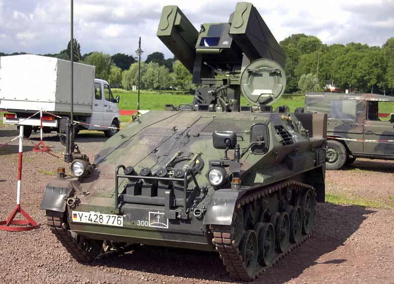

Wiesel has really skinny tracks as well.
