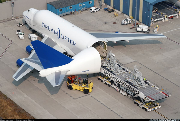

That's essentially what they did with the Boeing LCF as well. It's a 747-400 nose and wings with new fuselage plugged in and a new tail added. IT's pretty crude, all things considered -- for example, I read that they don't have APUs because the designers didn't wont to worry about how to run a fuel line to an APU in the tail when the whole tail swings off to one side for loading.
But you can see it's still a high-loader, not a true drive-on/drive-off arrangement. Drive-on/drive-off is harder to arrange, because you have to redo the landing gear, reposition the wing structure, etc.
Like on the Belugas, the bottom end of the original fuselage (everything up to the main floor) is still there. This reduces the amount of effort by a lot, compared to having to design an all-new fuselage.

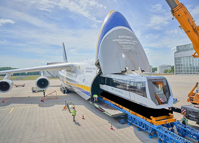

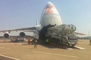

The An-124 can carry 150t, the An-225 even more. This capacity has been used in practice.
The Dreamlifter has a payload of 113 tons, and the Beluga XL can carry 46 tons. So neither can fulfill all use cases of the An-124.
And both require specialized handling systems for loading, whereas the An-124 is self-supporting: with ramps on both ends, cargo can be driven into the hold. If that's not feasible, the An-124 has cranes and ramp extensions on board.

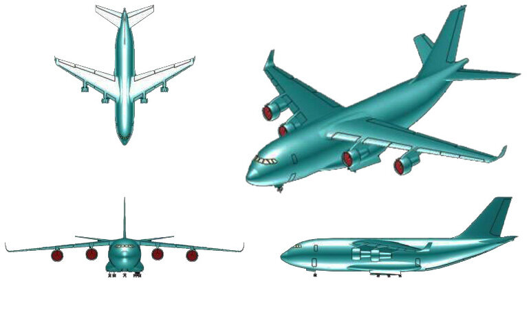

Is there a chance that at some point down the line the USAF might commision a new design to replace the C-5 ? But I wonder how big of a priority that would be for them with the sixth generation fighter in the pipeline.
It's an urgent priority for many nations now. On the Military and civilian side. Who would reach the prototype phase first would grab the bulk of orders.
China, France, Russia, or the USA are the most likely, with Brazil and Japan (quite) long shots.
China has the money and resources in theory, but their engine development has been very slow and unimpressive. There's little chance Western engines would be available for such an aircraft, so they'd need Russia's PD-14 to be available in the near term. Longer-term, we'll see.
France has the resources but not the money (alone). If they could pitch it as another pan-European project like A400M they might get it together but I'll believe it when I see the money.
PAK TA has not been seen in anything other than internet coolguy concept form, its engines aren't near ready, and the sanctions regime probably makes finishing it very unlikely in the near term.
The USA could refurb more C-5s, but USAF Galaxies aren't as easily available as the big Antonovs have been to non-Mil missions . If some of the boneyard airframes could be transferred to a commercial or quasi-commercial entity for rebuild as for-hire aircraft, that could probably do well until the Next Big Plane comes along.
Outside of government programs, if someone threw enough money at Scaled or Boeing we might see something interesting. Problem is the for-hire market isn't likely to pool that much money together to make it workable, and neither is likely to self-fund such an aircraft.

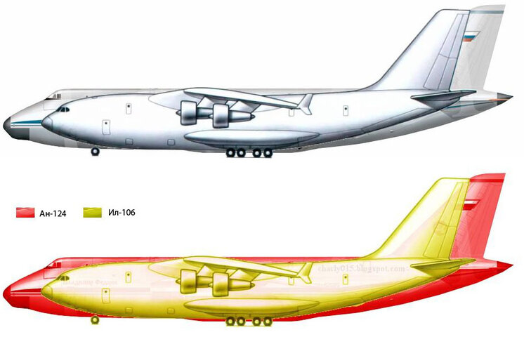

Is it possible that Russia could on its own put the AN-124 back in production with updated avionics and more fuel efficient PD-35 engines, or did they need Ukrainian cooperation to launch such an ambitious project ?
If that avenue is not open they seem to be considering two options, one is a clean sheet replacement that will be horrendously expensive to develop, and the other is something a bit smaller and less capable but within Russia's ability to build with the technology they will have in the near future.
