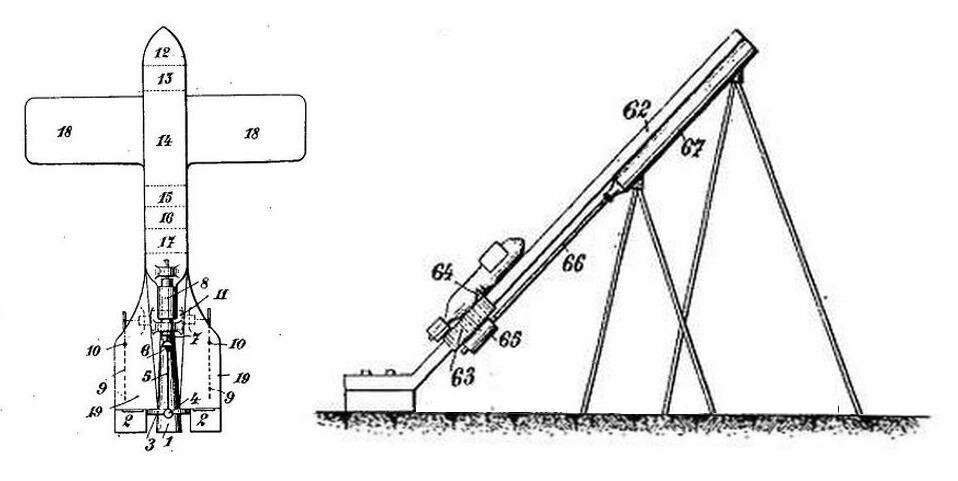

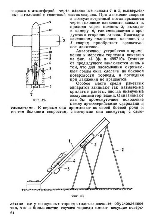

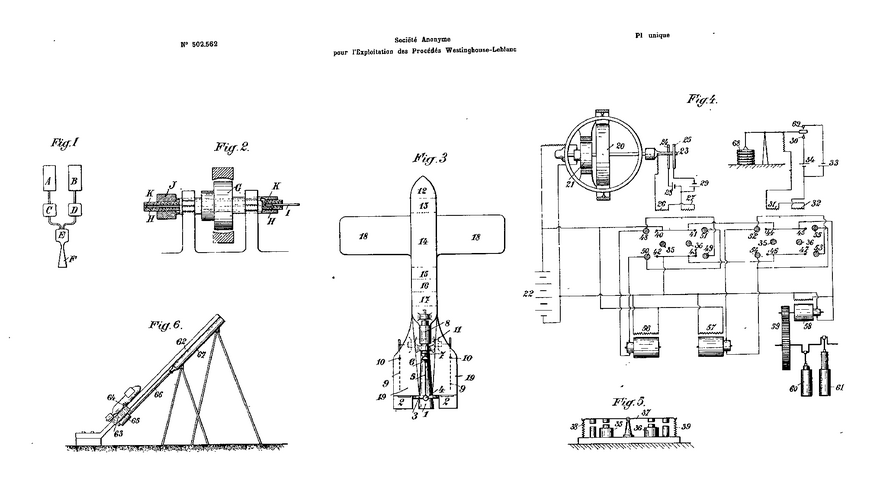

The torpedo contains an explosive charge and a fuel reserve, is equipped with bearing surfaces and in the tail section, it has stabilizers and rudders. The rocket engine with nozzle forms an extension of the body. The fuel is a mixture of gasoline and nitrogen tetroxide, both are stored in separate compartments of the body of the torpedo and introduced into the combustion chamber with the help of pumps actuated by an electric motor. A rechargeable battery is provided to power the latter, as well as to activate the gyroscopes used to control the rudders. All the auxiliary mechanisms are located in a separate compartment. In order to avoid a significant displacement of the center of gravity of the torpedo during fuel consumption, the fuel tanks are located symmetrically with respect to the center of gravity.
To give the torpedo its initial speed, a special catapult is used. The torpedo is mounted on a sled which can slide along the ramp. The torpedo, continuing its forward movement by inertia, flies away from the sled. The engine of the rocket begins to function at the time of the departure. For the initial ignition of the fuel, a small charge of gunpowder with slow combustion is placed in the combustion chamber, ignited before the launching of the torpedo. This charge heats a heat insulating jacket inside the chamber, which also serves as an igniter for the liquid fuel supplied to the chamber.It was another bold breakthrough that went unheard on the paths of history. Too often, ideas with great impact do not find a good audience.
