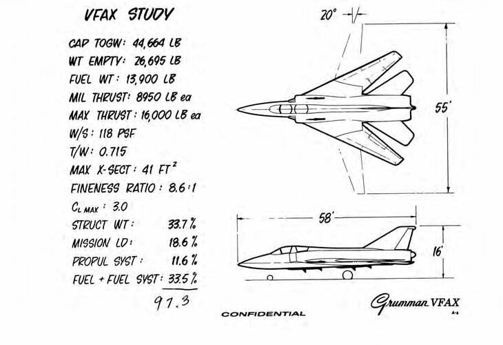

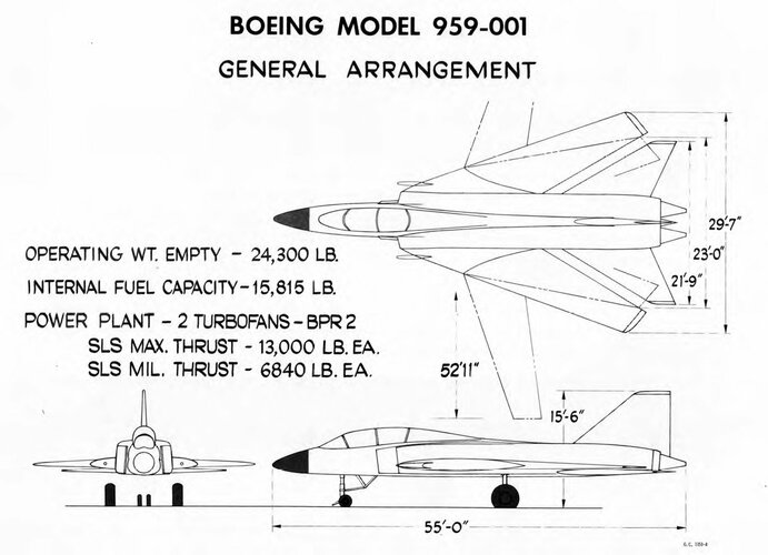

I'm looking for specs on aircraft like weight and proposed avionics and weapons. I've seen many photos of the contenders but little info on their engines weapons

The 1960's VFAX is what I'm looking for. I'm really interested in Grumman's and Vought's designs I believe they both presented Single and tandem seated twin seat designs.

Do you have a copy of Fighters over the Fleet by Norman Friedman? It covers VFAX in some significant details including drawings of Boeing, Vought and Grumman designs and specs. Initial designs were not expected to use Phoenix, but it was added as the designs grew.
