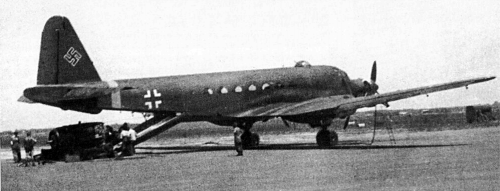

Without doubt one of the biggest neglects of the Luftwaffe was its failure to implement an effective replacement for the venerable, but by WWII, obsolete Junkers Ju 52/3m transport/cargo aircraft. Sadly for the Wehrmacht and Luftwaffe, the need of a modern and more capable transport/cargo aircraft was continuously neglected. Of course there was also the slow and vulnerable Messerschmitt Me 323 Gigant, and a handful of Junkers Ju 290's. And yet it is ironic that the aircraft supposed winner selected by the Luftwaffe/RLM to replace the Ju 52/3m – the Arado Ar 232 (an excellent and purpose designed and built STOL transport/cargo aircraft. It lacked the range required to completely fill the role.) . This is both strange and ironic when one considers that the 'Auntie Ju' was without doubt the Wehrmacht primery workhouse, to which there was never enough of them to support the German war effort!
Even more ironic is the fact that Junkers had seen the obsolescent of the faithful 'Auntie Ju' (especially when compared to that of the Douglas DC-3/C-47, let alone the Curtiss C-46 Commando, in the form of aerodynamics, speed, range and payload capacity) by 1938 and had discussion with Lufthansa (which would have involved the Luftwaffe by this stage of Germany's preparations for war) pertaining to a much more powerful, bigger, cleaner, faster and longer range replacement. This design would become the EF.77 design - the Junkers Ju 252. So great was the potential of the Ju 252, compared to that of the Ju 52/3m, that the new Ju 252 was twice as heavy (13,100 kg compared to 5,600kg), over 100 km/h faster (440 km/h compared to 305 km/h) and very importantly it had a dramatically improved range of 3980 km km verses 1300 km when fully loaded. In October 1941, the Luftwaffe took over the Ju 252's development. The Luftwaffe was fortunate that Junkers had already developed the Trapoklappe concept (the Trapoklappe, a hydraulically powered ventral rear loading ramp that possessed powerful enough operating mechanisms to lift the plane off its tailwheel, levelling the floor and allowing oversized cargo to be loaded directly forward into the fuselage.), which it had incorporated into the 5th & 6th Ju 90 prototypes in 1939, and so had proposed its incorporation it into the Ju 252 design. But as fate would have it in Nazi Germany, in the middle of a war, the RLM would not permit any disruption of the existing production lines, and was of the opinion that any replacement for the Junkers Ju 52/3m must make minimum demands on supplies of strategic materials and use powerplants not required by combat aircraft (the Ju 252 designed to use the Junkers Jumo 211F engine).
So it was detrimentally to both the Wehrmacht and Luftwaffe, that Junkers was instructed to investigate the possibility of redesigning the Ju 252 in order that a considerable portion of wood could be included in its structure, replacing the Junkers Jumo 211F engine with the BMW Bramo 323R engine of which surplus stocks existed. The result was the inferior and less capable Junkers Ju 352, whose wings were made of wood and the fuselage of steel tube and fabric.
Production of the Ju 252 was restricted to already completed prototypes plus those for which major assemblies had already been semi-completed, thus only 15 transports of this type were completed before production was switched to the Junkers Ju 352.
In fact I found this , which I thought was very interesting on the net some years ago and saved it to a ‘what if’ folder (sorry I don’t know the publisher!)
“One of the reasons the
Stalingrad Airlift failed is because the departure runway, within 170 miles of
Stalingrad was too small to handle all of the arriving and departing aircraft
that were supply all of the cargo and fuel. The Ju 252 could fly all the 1200 miles
all the way from Berlin, deliver 7 tons or so of cargo, take-off with a small
payload.
Eventually the departure runway was lost due to a Soviet armoured raid Tatsinskaya Raid) (which destroyed 76
aircraft) and forced the Germans to move their operations to an airfield 220
miles away. This then lead to reduced cargo and meant that aircraft with burned
out engines could no longer be used at reduced take-off
power.
The Ju 252 could bypass all this by delivering supplies the 1200
miles from Berlin to Stalingrad directly, landing and taking off with a small
return cargo and all without refuelling.
If operating from bases in Eastern Poland the Cargo only goes up.
The Ju 52 would require two stops on the way and a second cumbersome logistics
trail to supply fuel.
Without the Ju 252 the Germans realistically stood no chance of
supplying their forces in either Africa or Russia.
Some of the other possibilities include supply
Rommel.
For instance a Ju 252 could carry its maximum cargo of 7 tons or
so the 1200 miles or so from Berlin to Morroco and return with a small cargo all
without refuelling. It could carry
11 tons of cargo from Airfields in the South of France to Tunisia over about 680
miles. By dedicating a ton of
cargo 3 44 gallon drums and a 66 gallon drop tank Me 109 could be used to
shuttle escort the Ju 252.
Some 100 aircraft with an operation rate of 50% (75% is realistic
AFIKT) some 500 tons or cargo can be delivered in a day.
A 100 tons will keep over 100-150 tanks a full load of fuel and
ammunition everyday.
A further 100 tons will keep 200 trucks and support vehicles going.
A further 100 tons will supply food and blood for 100,000
soldiers.”
I thought it was very interesting!
More to follow over…………
Regards
Pioneer

German paratroopers failed to learn from thier early successes invading the Low Countries. They failed to learn that gliders were the quickest way to capture major choke-points (Fortress Ebam Emal).
Meanwhile only German and Italian paratroopers clung to the (obsolete) Salvatore harness, long after everyone else converted to modern vertical (e.g. Irvin) harnesses. Salvatore harnesses limited Fallschirmjager weapons to pistols and grenades?
Even Luftwaffe aircrew wore vertical harnesses.
LW also failed to learn from early successes with Junkers 52 tri-motored transports. Granted 20 years of development had resulted in great dispatch reliability .... but Junkers had already flown a prototype of the revolutionary tail ramp during 1939.
WI Junkers converted production lines to Ju252, 352 and finally the Ju452 with a nosewheel?
WI German soldiers glided into Crete with mortars and MG-34s in hand?
WI they were soon supported by glider-delivered Kubelwagens and light artillery?
WI Ju252 simply dropped rations (sans parachute) to German soldiers defending Stalingrad?
WI Theo Knacke invented low altitude parachute extraction systems in 1940?
WI LAPES delivered significant AT guns and ammo to sustain paratroopers for several days until they could be relieved by tanks?
WI LAPES reduced aircrew casualties during Crete, Market Garden, etc.?
WI greater successes with assault gliders and LAPES postponed the need to develop helicopters?
A decade later: "Goering's Revenge" (Junkers Tri-Motor) helped defeat "DeGaulle's SS" (Frech Foreign Legion) defending Dien Ben Phu because they could not deliver a sufficient tonnage of supplies. Even the handful of CIA-supplied C-119s were too late to salvage the French garrison.
Another decade later, US Marines successfully defended Khe Sanh primarily because US Army Cariboos, USAF C-123s and C-130s were able to deliver enough tons of artillery ammo to prevent the North Vietnamese Army from closing in. Sure most of those American airplanes were bigger, faster, longer-ranged, more powerful, etc. but the key difference was tail ramps that allowed them to quickly unload under fire.
Tail ramps were invented in Germany during 1939, the Luftwaffe failed to utilize thier potential for delivering cargo to troops under fire.
Ah, but they did develop the Arado Ar 232 - more flexible, easier to load, blueprint for the future. So perhaps not pursuing the Ju 252 was not a mistake but sensible as it was expensive and even the cheaper Ju 352 was less practical than the Arado design.

The Luftwaffe lost hundreds of the transport aircraft used to deliver the paratroopers when invading the Netherlands. I've read somewhere - can't remember where - this seriously hurt Germany's ability to deploy paratroopers.
Yes, both Arado and Gotha made pod-and-boom airplanes that set the pattern for 1950s military transports (C-119 Flying Boxcar, Nordatlas and Bristol Beverly).
Arado only made 20 Millipedes.
Meanwhile Gotha made about 1500 Go242 gliders of which more than a hundred (174?) were up-engined to become Go 244 transports. Gothas were big enough to carry Kubelwagens or 20 men.
Arado and Gotha tail-hatches speeded loading and un-loading - on the ground - but were not useful for dropping cargo. IOW early German designs were only the first step to perfecting modern military cargo airplanes. A disadvantage of pod-and-boom designs is that they had to leave thier tail-cones on the ground if they wanted to drop heavy cargo. Deleting the tail-cone increased drag, reducing combat radius.
I was speculating about how much Junkers engineers could learn from each successive generation of Ju52, 90, 252, 352 and a speculative 452. I was was wondering if a speculative Ju452 would develop the ability to open its tail ramp in-flight and drop cargo straight out the back (aka. Budd Conestoga). Dropping cargo in-flight vastly reduces casualties from AAA and during time on the round unloading. The next step is developing LAPES which further reduces exposure to AAA.
Size of cargo is less important than tonnage per hour, especially when all your artillery is working over-time to push attackers back from your perimeter.
As for casualties ... the Luftwaffe lost so many Ju52s at Crete (1941) that it crippled their air transport fleet for the rest of the war.
In conclusion: my speculation is about Germans learning the correct lessons from early assault glider successes and applying those lessons-learned to better generations of assault gliders and eventually to cargo planes with tail-ramps.
