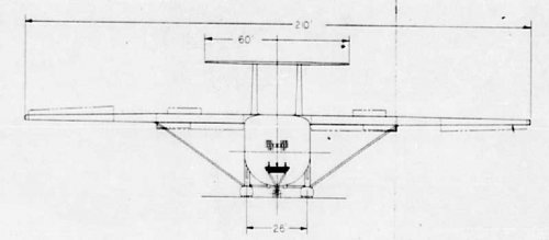

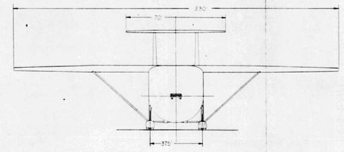

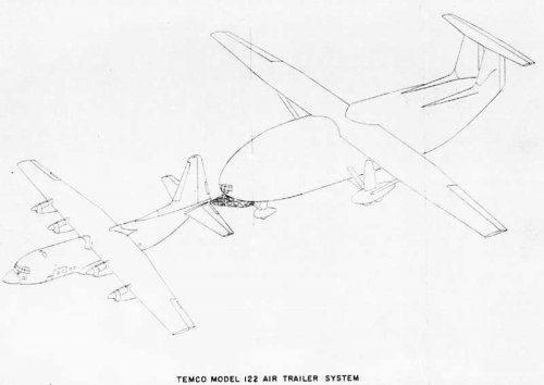

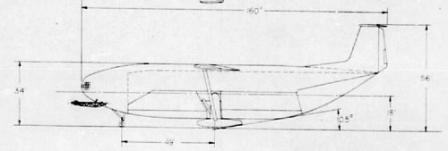

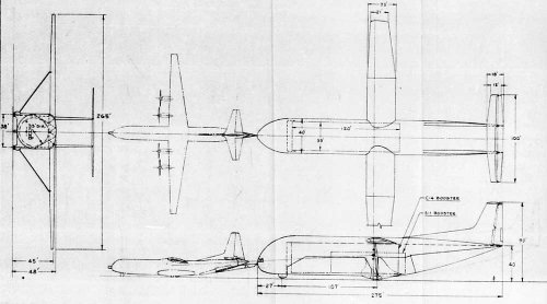

Here is an interesting concept for hauling Saturn C-4 Boosters.
They looked at C-130 and C-133 as "tugs".
Vought Archives
bill

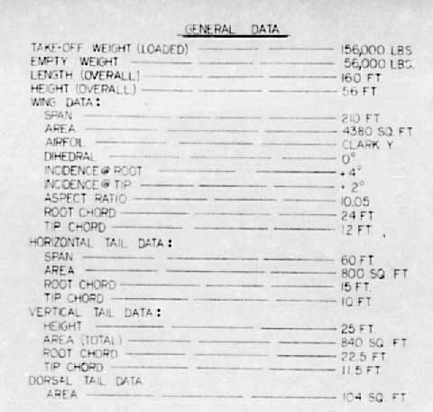

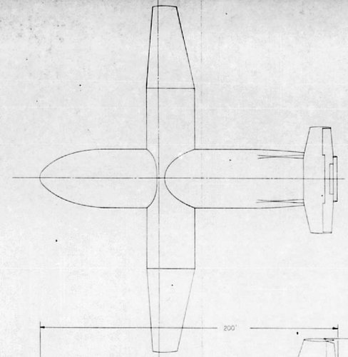

3 view and data block
Vought Archives
bill

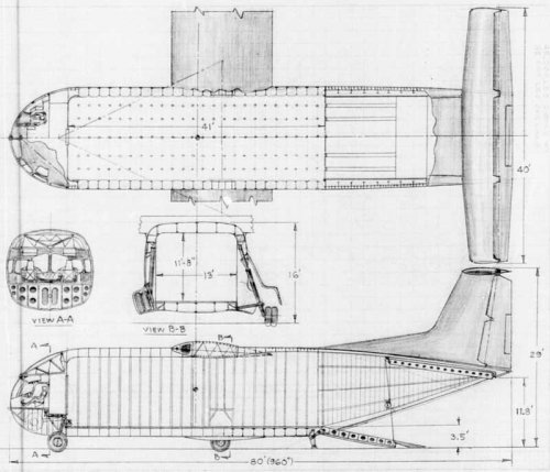

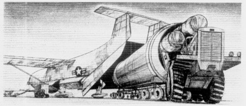

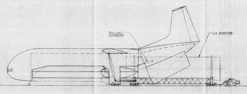

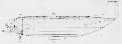

Here is a cutaway and load illustration
Vought Archives
bill
Orionblamblam said:
The "load" drawing shows a substantially different vehicle. Is this explained in the documentation?
Yes sir, there are 2 concepts. Only posted the one so far with that additional
drawing of a second.

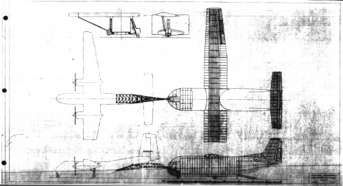

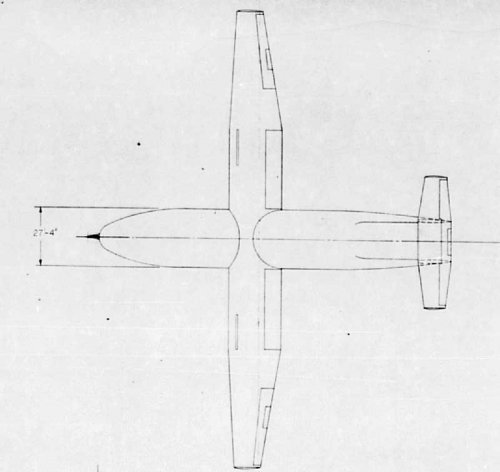

Growth potential version of the Air Trailer
Vought Archives
bill

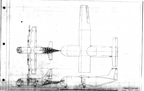

Temco Growth Potential Air Trailer with C-133 tug
Vought Archives
bill
One has to wonder if the mutual interference effects between such closely spaced lifting surfaces would have made the combined contraption flyable. IIRC, both the Deichselschlepp and a similar towed device tested by Miles were marginal in that regard.
Still, very interesting concept and definitely unknown to me. I have seen the towing idea pop up from time to time in discussions about energy efficient transportation concepts. Maybe we'll see more of this idea in the future.
Thanks for sharing!

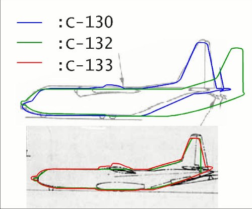

No need for excuses,
I'm really not sure, if the glider in the drawing I've posted really is identical with
the TEMCO design. Even considering, that the tow aircraft is said to be a C-132,
it looks much smaller and the Saturn booster obviously isn't carried fully inside.
C-133, not C-132 ! The latter was also Douglas but was cancelled before it was built.
"C-133, not C-132 !"
The text mentioned the C-132 and why not choose an unbuilt transport
as tow aircraft for an unbuilt glider ? ;)
But you're right, in the drawing itself "C-130" is written and the profile indeed
looks more like a Herk, not like the C-132, I would assume a typo.
So, this glider would have been even smaller! A rough calculation gives a
length of about 28m, compared to about 60m for the design posted by Bill,
so surely a different design, although maybe drawn by TEMCO for the same
purpose.
Drawing at the top of the page definitely represents a C-130 Hercules, but the one just above here shows a C-133 Cargomaster II. None of the illos shown here or on the links represents anything resembling the C-132.
You're absolutely right, of course ! Maybe I was fooled by the small
thimble radom, or maybe I need a new pair of glasses. ;)

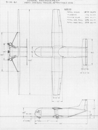

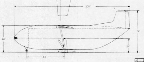

Here is more info Air Trailer specific
3 view and inboard profile

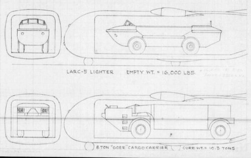

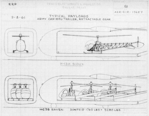

Here are some of the loading plans.
With such a ridged connection how would the tug aircraft even rotate to takeoff?
What possible advantage does this system offer over a more conventional cable tow? Is it intended to eliminate the need for a pilot in the trailer? If so, how is the trailer's role controlled?
Apart from the takeoff problem, it seams any disparity of movement between the units would cause a midair 3D 'jackknife'.
