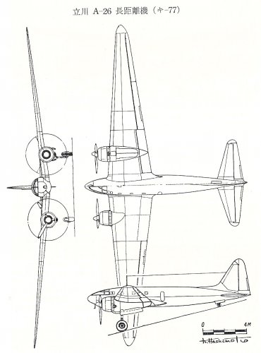

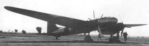

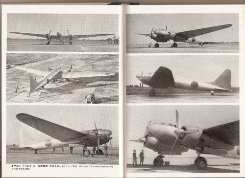

Hi! The Tachikawa A-26 Long-distance plane(Ki-77).
Wing span:29.437m, Overall length:15.3m, Height:3.85m(ground position), Wing Area:79.56m2, Empty weight:7,237kg, MTOW:16,725kg, Max Speed:440km/h(4,600m), Range;18,000km, Service ceiling:8,700m, Engine:Nakajima HA115 special type(1,170hp in take off).
A-26 marked non stop 16,435km flight in Manshu(1944/7/2 to 7/4). Flight time:57hours12minutes, Average speed:288.2km/h, Residual fuel after flight:800L.
If she used all fuel, she could fly 18,000km.
Source:My No.2 bible.

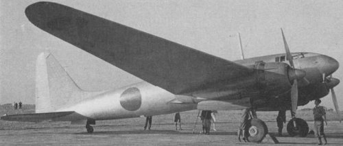

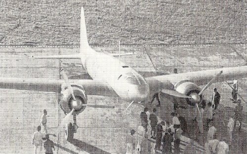

Hi! Another A-26(Ki-77) pictures.
Please enjoy Japanese beauty.
