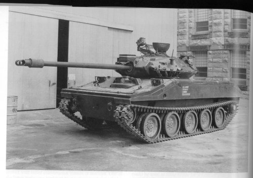

Are you sure it was T95?
Sheridans were fitted with some non-standard turrets, one reason being the low reliability and life of the 152mm launch tube.

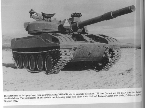

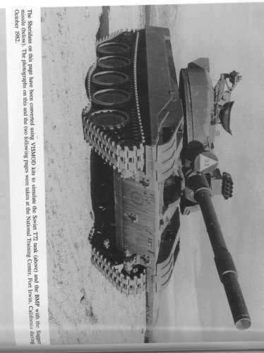

Sorry about the last one. And I should have acknowledged source: "Sheridan" by Hunnicutt
Some T95 variants mounted turrets with smooth bore guns

By the way, in my first pic the gun is a 76mm Walker Bulldog turret.
