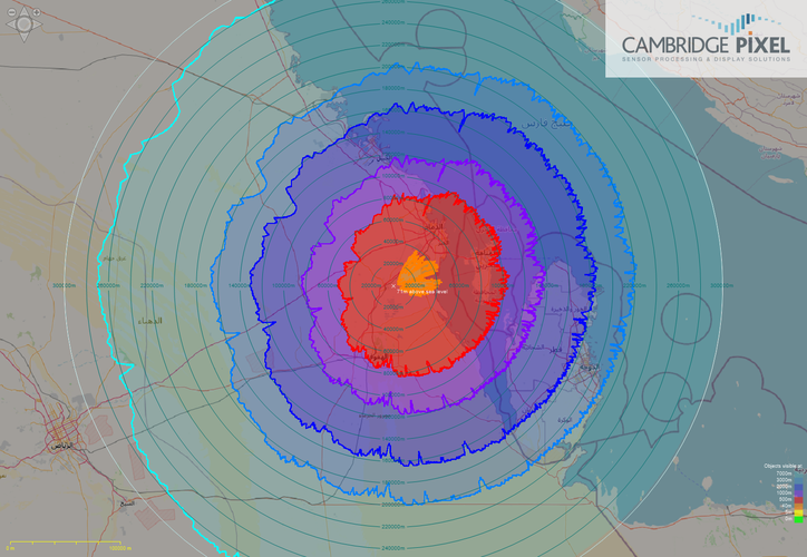

To Illustrate the problem here is the coverage of possible Pantsyr S-1 Battery in Aleppo.
This assume 5 meter height Antenna. The colors indicate target Altitudes. The legends can be seen at the lower right of the image. As seen the Pantsyr at that particular assumed Area can only provide Full 360 degrees coverage on target flying at 2000 m. The lower, the more the Geography punishing the Pantsyrs. Down to the point that anything flying lower than 500 m is essentially undetectable.
We can compare with hyphotetical Aircraft Coverage... 1424 meter altitude.
It has better coverage, much better and even at some area it can cover very low altitude target. although not 70 meter.
