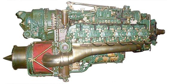

A green ammonia fuelled Napier Nomad II for a stationary engine.
Near constant volume combustion, maximising the Carnot cycle efficiency, combined with low temperatures combustion for ultra ow NoX.
Hence a Zero CO2 emissions, ultra low NOX, with a very high “well to plug” conversion efficiency, taking advantage of green ammonia opportunities to offer the low cost means to transport/store energy capture at an optional location and release it in a high power density format at point of use.

An green ammonia fuelled Napier Nomad II for a stationary engine.
Nice, would have gone in the Shackleton, that would have given some range boost.
