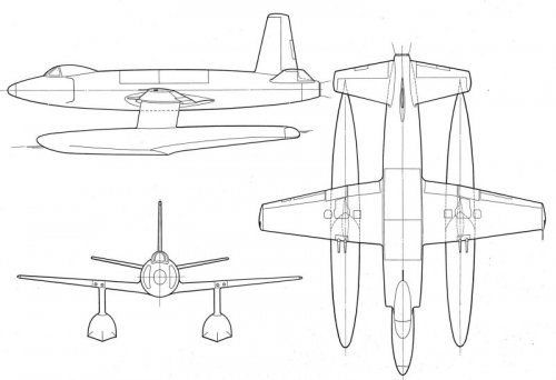

Supermarine Attacker on floats
Thanks for sharing!
Very nice layout, never seen it before :cool:
It looks,like famous Spitfire-on-floats.
Is there were more information about this project?
Some additional details about it's year of design and purpose would be quite welcome!
Sorry, that's all I have. The drawing is undated but the Type number would place it in the late 1940s.
Very interesting! Thanks a lot, Schneiderman.
Do you know the name of the artist who did the three-view? It's really nice.
It seems to be an answer to a question no one was asking, unless it was "How can we make the Attacker worse?" Could you be a bit more specific on the source?
Sorry, I should have made it clear that this is an official Supermarine blueprint, drawing number 54200 sheet 1.
There is no indication why the project was initiated but I would suggest that is may be related to OR.170 and Spec. E.6/44 which covered the Saro A.1 twin-jet flying boat.
You have found a very rare item Schneiderman..thanks.

Supermarine often drew up speculative designs and concepts but these usually got no further than Technical Reports or similar. To have been allocated an official Type number does suggest that it was in response to some official requirement, UK or overseas, but I really cannot see what this could have been.
On the other hand my Schneider Trophy background does make me wonder whether they were possibly considering making an attempt at the Seaplane speed record. One Attacker prototype was used to set a 100km closed-circuit speed record so they were definitely interested in such things.
Putnam's book about Saro clearly states, that entire E.6/44 specification has been "drawing around" Saro proposal for jet fighter flying-boat.
Perhaps, Attacker floatplane was intended to be it's competitor, on the stage, where Saro A/1 has already been built, just an attempt to obtain extra contract?
In my humble opinion, Attackers floats looks to big, and air intakes to close to the water surface.
Could it be a record-breaker?
Why not - but why this drawing shows aircraft, armed with four guns?
If anyone of members owns Air Britain book "The British Aircraft Specifications File", which (I guess) contains E.6/44 specification and would be so kind to share it, perhaps we knew answer on some questions?
No, nothing in the Air Britain book.
Certainly spec. E.6/44 was written around the Saro A.1 but it is just possible that Supermarine's design was also intended to meet the original OR.170. However I don't think that is too likely as the design is a bit too late, somewhere around 1949 I would estimate.
At the time there were strict export restrictions on military aircraft and it is hard to see who, on the list of acceptable customers, would have wanted such a fighter.
