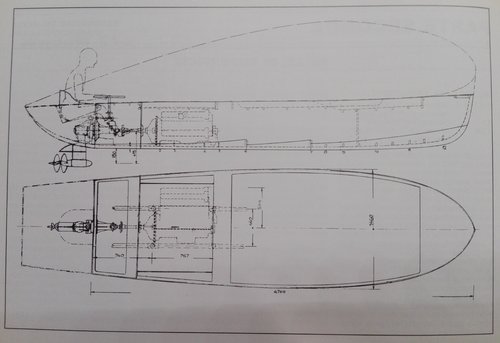

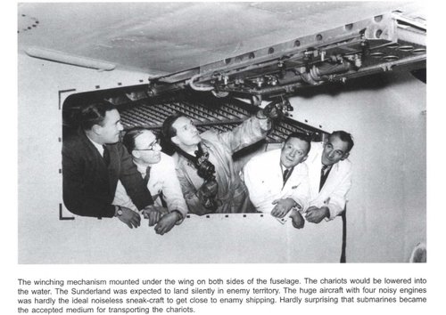

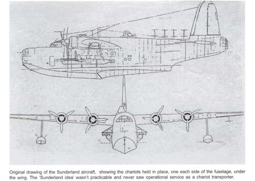

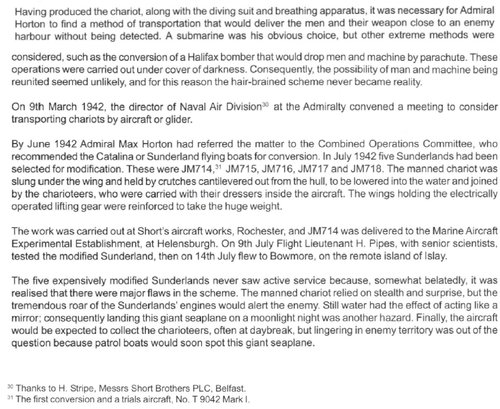

Hi, I found some info (page 51 and 61), a drawing and a picture (page 57) in this book:
Robert W. Hobson
Chariots of War
Ulric Publishing
2004
The picture (Chariots of War2.jpg) shows the usual mechanism to release the depth charges stored inside the fuselage, but maybe it could be used also to lower the Chariots into the water. Surely the picture was not taken during the test with the Chariots, I am doubtful of the need of a BBC speaker during the test of a secret project... ;)

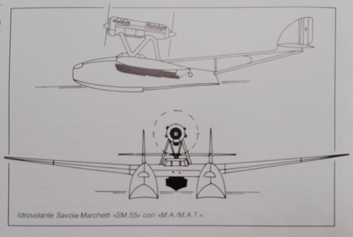

Addendum: I know it is not a Chariots, but during spring-summer 1936 the Italian Navy made some experiments to carry a MAT (Motoscafo Avio Trasportati, --> Airborne Speedboat) under a Savoia-Marchetti S.55 flying boat. See below some images, taken from the wonderful book
Marco Spertini, Erminio Bagnasco
I mezzi d'assalto della Xa Flottiglia MAS
Albertelli editore
1991
616410
616411
