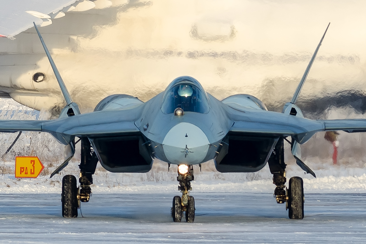

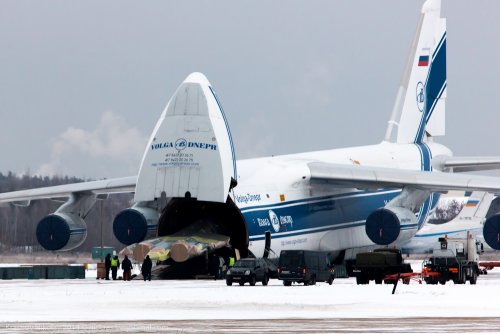

I'm a bit surprised that this was not posted here ... fount at the Key-Forum: T50-7 - a static test-airframe - arrived at the Gromov Flight Research Institute (LII) at Zhukovsky !

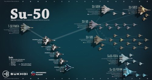

A development timeline apparently posted by Sukhoi (this also apparently confirms the Su-50 designation?):
Edit: woops
Erm.. no.
http://www.gizmodo.com.au/2015/02/cool-graphic-shows-the-evolution-of-russias-next-generation-fighter-jet
http://bbb4445.deviantart.com/art/Su50-Pakfa-Timeline-509059200
Fanart.

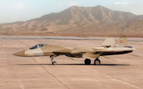

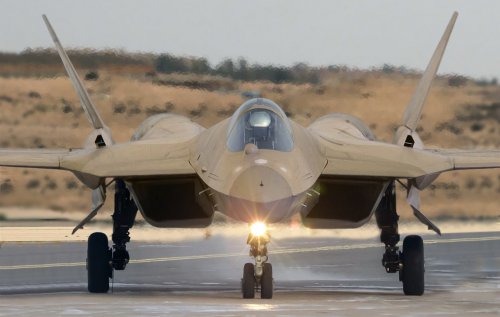

If you don't mind me asking, what proof do you have that they are Fanart? Your link certainly doesn't suggest it. Oddly enough, your link here has "deviantart" in its address but its nowhere to be found in the site it takes you to...
I ask, because there's also a few images that were posted a few weeks ago that show Sukhoi T-50 #054 painted in a new desert scheme and has Syrian, Russian, and Iranian flags painted on it (along with some Arabic/Persian writing, no clue on meaning). Could of course just be creative advertising by Sukhoi.
The linked article states:
The timeline above was made by a fan based on this official Su-30 graphic by Sukhoi, which has been modernizing its current flagship fighter, the Su-30 — a twin-engine two-set beast for” all-weather, air-to-air and air-to-surface deep interdiction missions” — since its 1992 introduction.
Seems pretty explicit to me.
The text of the URL leads to the DeviantArt account of the artist who created the new diagram. Try this link:
PS: I'm fairly sure the desert camouflage pictures are fake. They have a slightly CGI look to them, and the original source appears to be an AsianDefenseNews page that is no longer online.
TomS,
Ok, so here are the issues I'm seeing with your explanation:
- Article only mentions "fanart" concerning the Su-30/English poster, NOT the Su-50 poster.
- Article states the author created the English language poster from an official poster from Sukhoi, but yet this poster is missing from his DeviantArt page.
- The DeviantArt member DOES have a Russian poster for the Su-50, which has a hashtag for Russia's official export entity, but his English poster does not.
- Why would the DeviantArt member have a Russian-language poster for the Su-50 but NOT the Russian Su-30 poster that is discussed in the Gizmodo article?
Of note, those desert-scheme images are ALSO on this same person's page. I have inquired with the member to see if the images are "real" or his works of art.
I personally found those images on PakistanDefenseForum, posted on 04 January this year.
Hopefully I'll get a response from the DeviantArt member and help clear this all up..
Once more. This is fan art. Author has used unofficial Su-30 poster as a basis for his view on T-50 development. Neither of these both comes from Sukhoi itself.
Sandermakoff was an author of original Su-30 poster he made for DefendingRussia.Ru
http://sandrermakoff.livejournal.com/752132.html
50-4 renders are fan art as well.
I screwed up the original links slightly, there were two which got mashed to one. The deviantart one links to the artist directly, I would call that conclusive.
Its pretty obvious that its fanart. It doesn't look even vaguely plausible as an official Sukhoi chart. How can there be designations now for non-existent Iranian Su-50s?
This is almost deliberately obtuse. The article refers the T-50 poster as fan art. It is displayed above the text that says "the above was made by a fan" The bottom image is the original Russian poster about the Su-30 from the official DefendingRussia website. There's a link in the text that leads straight to the Russian page with this image.
That's why the Russian Su-30 poster isn't on DeviantArt - the user didn't create that image, but did create the other three (Su-30 English version and both versions to the T-50).
A few other giveaways:
1. Sukhoi can afford English speakers to proof its marketing copy. The English T-50 chart is littered with spelling errors (I count at least 8).
2. South Korea didn't order the T-50, much less for delivery in three years. In reality, it just ordered the F-35.
TomS & PaulMM,
Much appreciated for the clarification. I've been trying to calm folks over at the IMF for the last day on that poster (though I just suspected it was "creative advertising" by Sukhoi).
When I read that phrase in the article, I thought it was referring to the Su-30 poster just below it.
I'll try to spread the word on the poster..

UPDATE:
Concerning the T-50 in a desert paint scheme, I so far have had no luck finding a possible source for this claimed PS'd images. I've gone through quite a few images so far (including all 162 images on Airliners.net). I found a few possible matches but the shadows and angle of the aircraft don't match. I also made sure not to limit my search to any one prototype.
If these images are PS'd, the "creators" did a good job of picking an image that doesn't appear to be easily found. Which would suggest 2 possibilities to me: Either this is some high-class trolling (aka done by folks with access to some 'unique' original images) or the images are real.
The first one appears to have inconsistent shadows - it has likely been superimposed on that background. Most likely both are colourised and placed on these backgrounds.
The front view is probably based off this image
Note that the heat mirage is wrong in the altered image. In the altered image, it's equally intense below the fuselage as above; in the original, the heat rises (as one would expect) and the view below the aircraft is much less distorted.
And here's the likely source for the side image:
Google's Reverse image search is a great tool for this -- toss the suspect image into the search box and it returns similar matches based on shape.
The first image is a bad photoshop job actually. As someone who has some background in art, I can see that the dimensions are off. If you can visualize the plane the aircraft is on vs the plane of the ground. They are on 2 different planes. The shadow is very telling.
