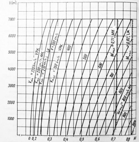

The following diagram shows limiting/allowable speeds(Mach numbers) and altitudes for attached stores 4xFAB250(8xFAB100), 2xR-60. The allowable max. speed of flight is limited by the strenght of the fuselage, wing mechanization and weapon pylons.
Diagram explanatory: VPK=LTC - Landing/Takeoff Config, LK=FC - Flight Config, MK=MC - Maneuver Configuration
The max. allowable Mach number for stores with four FAB250(8xFAB100) and two R-60 is 0,82Mach(FC) and 0.71Mach(MC). The max. altitude level (7000m) is given by the ability of the pilot to work in the unpressurized cabin.
For some other stores configuration, as for instance 32xFAB100, 2xR-60 or 4xFAB250, 2xR-60, 2xPTB-800 or 2xR-60, 4xPTB800 the max.allowable Mach number is 0.6 for both the FC/MC regimes.
source: Su-25K practical aerodynamics

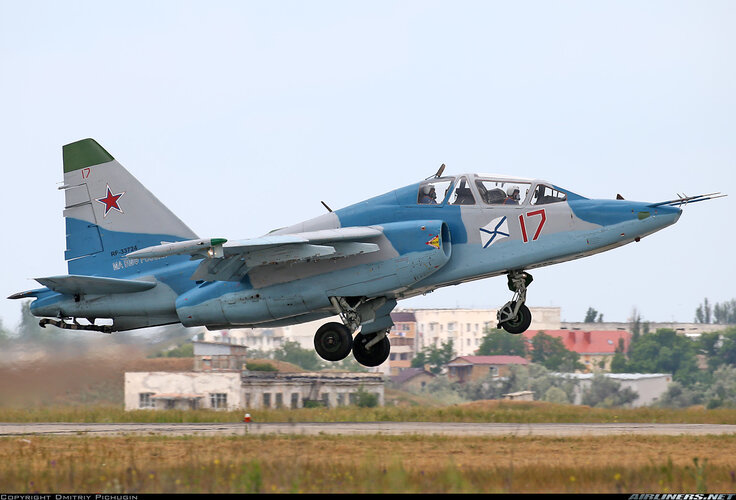

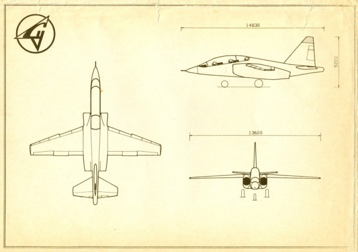

Wasn't there also a three-seat courier version studied of the Su-25UT/Su-28?
I believe the 3 sea model was known as the Su-25UB-3.The Idea,IIRC was to cut the cost of training by having two students train at the same time,on the same aircraft,with one instructor.
Again a project from the desperate times(early90`s) of the design bureau Sukhoi. I`m really not surprised why most of Mr.Babak "pocket" proposals never got further than outline design stage. This is another crazy idea coming out of his head to build a jet trainer on the basis of the Su-25UB to teach VVS pilots to take-off and land. This project named the Su-25UZ "Ruskaya Troika" was not designed for carrier based operations.
The baseline Su-25 itself has been known for its tricky behaviour during take-off and landing phase. The problem lies with the short spacing between main wheels causing lateral instabilities and oscilations when applying improper pedal inputs during acceleration/decceleration on the runway. When the Frogfoot touches the ground with all three wheels, pilots are instructed to release the brake chute at first and not to compensate the course and maintain runway alignment with pedals what could lead to the swinging motion of the aircraft. Things are going to become even more difficult when compensating for cross-wind. The aircraft is also very sensitive to cross-wind due to its big "boxy" side area, afaik landings with cross-wind up to 10m/s are considered safe, whereas the Mig-21 round fuselage can handle cross-wind up to 20m/s without a problem . The Su-25 has very unusual pedal steering/braking mechanism, not common on other soviet aircrafts.
Making a jet trainer for the flight schools from the Su-25 is a pure madness, that is my opinion.
I bet that two L-39 Albatross jet trainers are still cheaper and better solution for the basic flight training than the 3-seat Frogfoot having even that disgraceful nickname "Russian threesome". ;D ;D

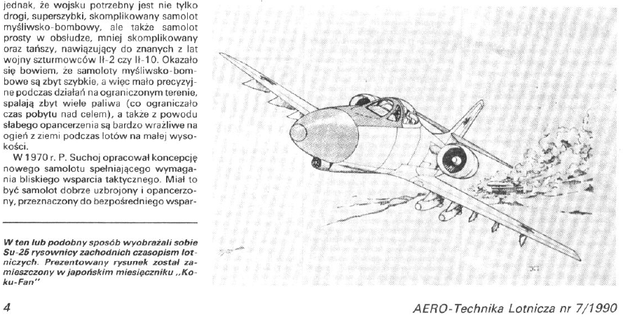

Strange concept; Aero Technika Lotnicza 1990-07 - Su-25.
I suspect that this is a derivative of one of the imagined A-10 lookalikes that were all over the US aviation press prior to actual sightings of the Su-25.
