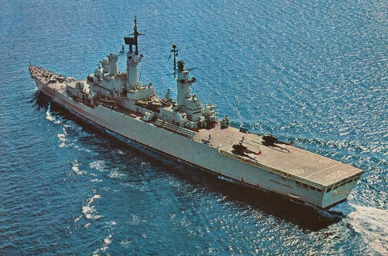

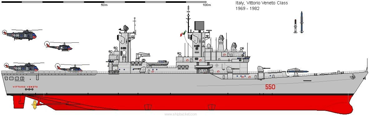

Ok, in which case, how about something like a derivative of the excellent and very capable Italian Vittorio Veneto cruiser replacing the carrier HMAS Melbourne? This gives the principle offensive strike mission within the ADF to the RAAF (A-5C+ Vigilante) and RAN (Oberon-class diesel-electric subs).
Not does the Vittorio Veneto carry a very large complement of helicopters, but it has its own very capable offensive/defensive sensor and armament, including:
  • 1 × Mk 10 twin-arm launcher for 40 RIM-2 Terrier and 20 ASROC missiles;
  • 8 × Oto Melara 76/62mm DP guns;
  • 2 × 324 mm triple Torpedo tubes;
  • a three-dimensional AN/SPS-52 B radar
  • a SPS-768 (RAN 3L) air search radar.
  • a AN/SSQS-23sonar for ASW
  • and check this out - 9 x Augusta AB 204's or AB 212's or 6 x Sea King's!!!
With a complement of 557, Australia could technically operate three of these excellent cruiser's (not that politicians/government would endorse such an acquisition.)
Swap out the ASROC capability for two Ikara launchers and magazine in place of at least two of the Oto Melara 76/62mm DP guns.
Replace the 20 x ASROC rockets with 20 x additional RIM-2 Terrier.
Replace the Augusta AB 204's or AB 212's with 6 x Wessex helicopters (and later Sea King's).
Perhaps four of the Oto Melara 76/62mm DP guns could be replaced by two single barreled 127mm DP mounts?
Rb.08 or Turana derived anti-ship missile.
[P.S. Does anyone do Shipbucket profiles like to have a go at the above mentioned modifications?]
Regards
Pioneer
Actually she looks like a perfect solution. Big, seaworthy, capable of both area air defense & anti-submarine hunting, and more than capable of self-defense against both air & surface targets (her eight 76-mm guns could probably tear a destroyer apart). Great idea, Pioneer!
Then when it comes time to replace the Vittorio Veneto-based cruiser, perhaps consider something like the design proposed by Commander Ronald J Ghiradella, itself based on a modified Spruance-class hull and machinery, which incorporated the following:

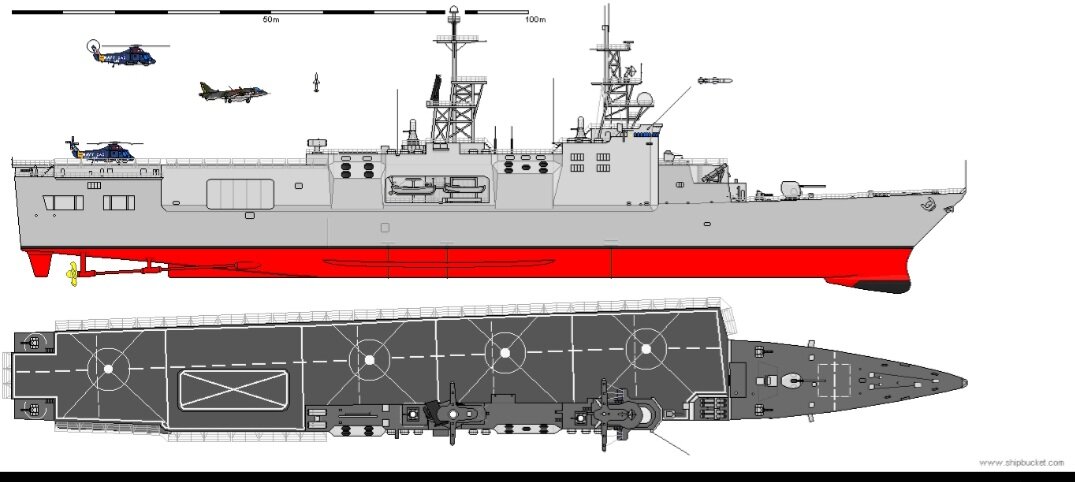

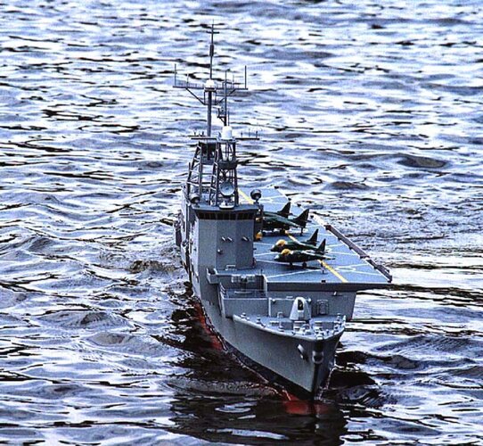

"basic Spruance hull lengthened to 606ft overall; the gas turbine uptakes are trunked to starboard where an island superstructure is located, making room for a 470ft flight deck angling to port. Forward, there are conventional weapons: a 5in gun and Harpoon anti-ship missile canisters, with 30mm guns sited on each quarter to provide close-in AA defence, and a Basic Point Defense Missile System is located aft of the island. There is a long, narrow lift (62ft by 26ft) aft of the island. Ghiradella foresees two hangar decks, the main one on the original main deck, with a lower hangar deck extending from the lift aft to the stern. In spite of the fact that the lift is too narrow to handle Harriers, Ghiradella gives the aircraft complement as twelve 'medium-sized' helicopters and four 'Harrier-type' aircraft.'"
Minus the Mk71 203mm DP gun (swapped for a Mk45 127mm).
Regards
Pioneer
