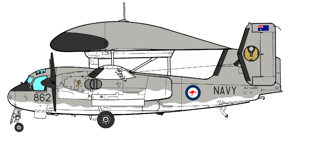

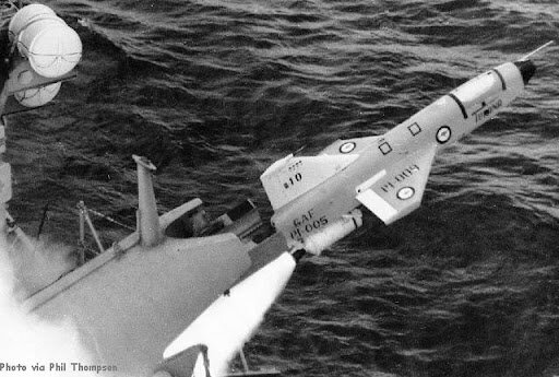

Well, Australians already working on Ikara by late 1960s. The simplest solution would likely to work from it's hardware. Look at GAF Turana target drone (first flight in 1971):
It was basically an Ikara with small turbojet engine (Microturbo Cougar 022) replacing solid-fuel rocket. During testing, it proven capable of flying as low as 11 meters, as fast as 750 km/h and as far as 500 km.
Basically all you need to turn Turana into anti-ship missile, is to reduce the range (100-150 km would be more than enough) install a warhead (just a simple HE bomb hanged below the hull under the blister would work) and install some kind of terminal homing guidance.
I like the way you think Dilandu!
I was just about to suggest that Australia look at acquiring Swedish Saab Rb 08 anti-ship missiles to counter the powerful growth and threat of Indonesian surface combatants, but your suggested adoption of the Turana into anti-ship missile makes a hell of a lot of sense - especially when one considers the political implications and inherent restraints of terms and conditions associated with Swedish weapons - Australia could use Rb 08 in a defensive manner, but not in an offensive manner!
Add to this the rudimentary capabilities of anti-missile weapons and sensors of both Western and Eastern warships.
I'd like to take your Turana anti-ship missile idea further, if I may, and develope both a land attack and reconnaissance derivative!
So we can potentially have the following derivativs of the Turana:
-Ship-based anti-ship missile;
-Ship-based land attack missile;
-Shore-based anti-ship missile;
-Ground-based surface to surface missile;
-Ground-based remote piloted reconnaissance drone;
-Ship-based Ikara anti-submarine missile, from which its design is based;
-and of course, in it's orginal form and purpose as a target drone.
Makes for a very practical indigenous weapons program, does it not.

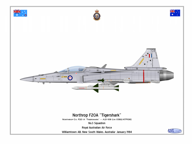

Equipped with the Cyrano IV radar and two Super 530 and two Magic AAM's, makes for superior all-weather fighter/interceptor for a reasonable price [although, I'd probably favour the incorporation of Aim-7 Sparrow or Skyflash AAM in place of Super 530 for commonality purposes of RAAF].
Ideally, Australia/RAAF would pursue Dassault's unique Mirage F1 offer by going one step further and pursue the even superior and more versatile multi-role Mirage F1 M53.
Therefore the carrier wouldn't be on the chopping block until the Mirages and maybe Phantoms, get replaced with ~100 multi-role fighters with long-ish range and IFR capability. RAAF AEW would also be nice, as the Melbourne and her TF would provide a valuable intelligence bubble.
Ok, so come this time of requiring ~100 multi-role fighters with long-ish range and IFR, I would seriously be looking at a Hi-Low mix for both cost and capabilities purposes. In which case, I'd be favouring the license-build of Northrop F-18L Cobra (Hi) and F-20C ['Big Wing'] Tigershark (Low) mix.
[Northrop F-20 Tigershark profile by GLanini & Dassault Mirage F1 profile by ysi_maniac]

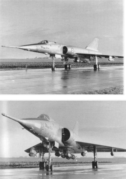

Actually... what about Mirage IV? It was proposed for export in 1960s, and Australia took interest in such proposal (the F-111 eventually won, but there was a serious arguing for Mirage IV). By the 1968, the type was still in production.
The Mirage IV didn't have the range, especially when you factored in the induced drag of external conventional bombs the RAAF deemed as its principle weapons load.
I'm sure the orginal - hence the proposed Mirage IV offered to Australia, lacked terrain avoidance radar.
Dassault did propose a version of the Mirage IVA with Rolls-Royce Avon engines, which I would encourage (given that I would have stipulated Avon-powered Mirage IIIO's, from the getgo!).
[Pictures of Mirage IV armed with 1,000-pound GP bombs from https://combatace.com/forums/topic/35771-mirage-iva-wip-update/?page=3]
