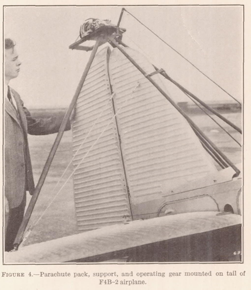

Spin recovery parachutes were tested by NACA on the Boeing P-26 and the FB-4. This testing effort may be where the Russians obtained their information.
Below is the installation of the spin chute of the FB-4. Also the attached paper.
chrome-extension://efaidnbmnnnibpcajpcglclefindmkaj/https://ntrs.nasa.gov/api/citations/19930091602/downloads/19930091602.pdf
