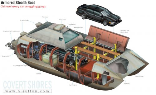

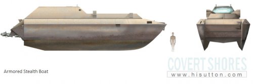

I pulled together the info I have and did an article, centered on the Armored Stealth Boat found in China, which was actually a car smuggling boat not a landing craft. http://www.hisutton.com/Armored%20Stealth%20Boat.html

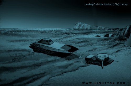

Military relevance bit:
The usefulness of a discrete (read ‘stealthy’) landing craft capable of putting a Main Battle Tank (MBT) ashore undetected has been raised by some Naval Infantry / Marines units in NATO. Current mechanized landing craft (LCM) are susceptible to antitank missiles, and are not discrete enough to take an enemy by surprise. Consequently commando raids to neutralize local air defenses and to secure the landing beach are primarily infantry affairs, landed by small boats or helicopter. Again, both are liable to detection. The ability to land even a single MBT as part of the pre-landing raiding or securing force would be a game changer.

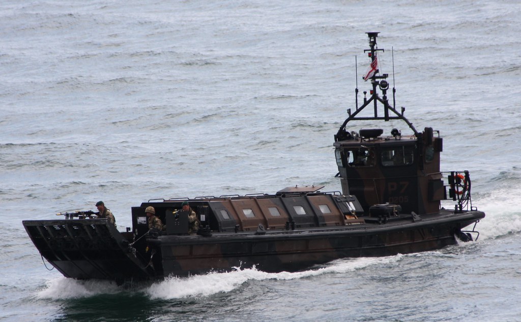

BAE are making their pitch for the replacement of the Landing Craft Vehicle Personnel mk5 which is likely to be a joint UK/Netherlands procurement tendered next year. They are pitching a stealthy 40 ton 18m craft with a trimaran bow and landing ramps fore and aft capable of carrying a light vehicle such as a 4x4.
