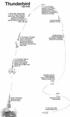

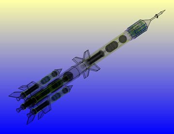

Starchaser Industries is a British company developing sounding and space tourism rockets. Before describing more recent work, thought I'd post details of their original Ansari X-prize entry Thunderbird.
The following vehicle and mission specs come from the attached PDF which is from the original X-prize site:
[quote author=http://space.xprize.org/files/downloads/ansari/starchaser.pdf]
VEHICLE SPECIFICATIONS
  • Name: Starchaser 4 (launch vehicle), Thunderbird (spacecraft/cabin)
  • Length: 27.5 m (90 feet)
  • Diameter: 1.6 m (5.3 feet)
  • GTOW: 20,000 kg (44,000 lbm)
  • Dry Weight: 10,000 kg (22,000 lb m)
  • Crew Environment: Pressurized cabin with commercial IVA suits
  • Payload Capacity: 400 kg
  • No. of Engines: 4 strap-on boosters and 1 engine on 1st stage, 1 engine on 2nd stage
  • Propulsion System: Pressure fed
  • Fuel: Undefined hydrocarbon
  • Oxidizer: Liquid Oxygen
  • Total Thrust: 75 tons
  • Reaction Control System: Cold gas
MISSION SPECIFICATIONS
  • Alt. at Ignition: Earth surface
  • Orientation at Ignition: Vertical
  • Max. Accel. Force on Ascent: 5 G
  • Time and Alt. at 1st Stage Engine Cut-off: 60 sec at 24 km
  • Time and Alt. at 2nd Stage Engine Cut-off: 90 sec at 54 km
  • Max. Speed: 1,500 m/s (3,360 mph)
  • Max. Altitude: > 100 km (62 miles)
  • Time in Weightless Conditions: 4.5 minutes
  • Reentry Method: Ballistic reentry
  • Accel. Forces on Descent: 5 G
  • Landing Method: Steerable parachute
  • Total Duration: 23 minutes
  • Landing Distance from Take-off
  • Location: 0-5 km
  • Time Between Missions: 7 days
[/quote]
Update: some further images at http://www.starchaser.co.uk/index.php?view=gallery_thunderbird (several attached)

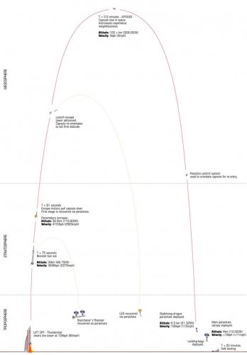

Longer-term Starchaser envisage a space tourism spaceplane. I've been unable to find any details of this, other than the attached flight profile from their website.
