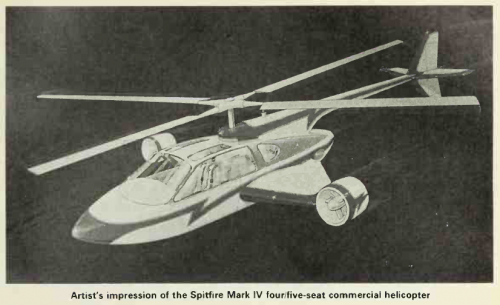

Ans from JAWA magazine,here is an artist drawing to it,as a close support and
light attack helicopter,but I don't know if it real design or not.

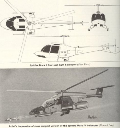

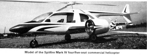

here is an artist drawing to Mark IV helicopter.

Reminds me of the Enstrom 480 in the second artis depiction

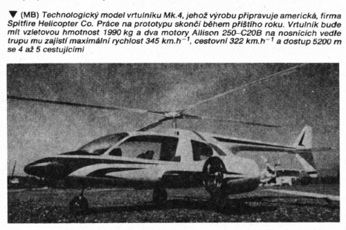

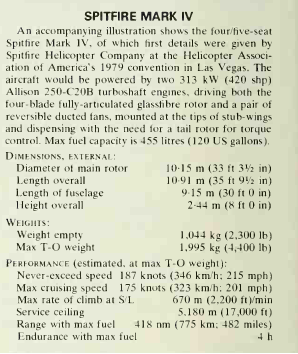

From JAWA 1981.

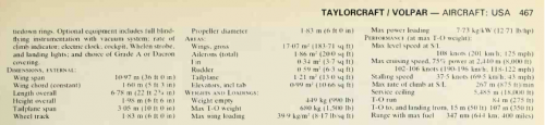

From L+K 21/1980
the estimated speed 345 km/h ?.
