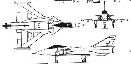

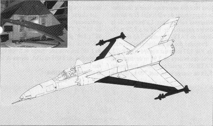

Even if it does not correspond exactly to this "fictitious country", I think that South Africa would have been the country which was closest to it (even more so than Israel with the Kfir).
In addition to the Aero Sud Super Cheetah D (with the SMR 95 engine of the MiG-29), there was also the study of the wing capable of supporting a missile at its end.
Otherwise, I still find that this artist's achievement (which I have never identified) would have made a magnificent evolution of the Mirage III (except for the front view).
