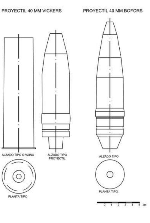

I found one diagram with a drawing that allegedly depicts her projectile.
What is known about the shells for this gun?
In which tape were the shells stored: made of cloth or iron?

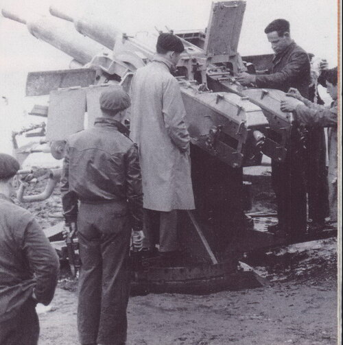

Maybe Tony Williams knows what kind of shells were on this gun?

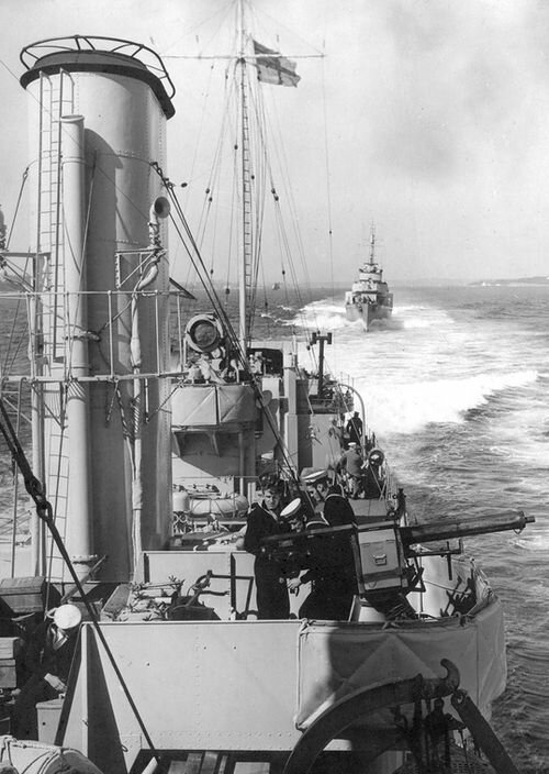

Here is another perspective of the gun.

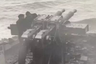

Isn't that a picture of the single barrel pom-pom used by the Italian navy?
Yep. Terni was owned by Vickers and they produced such guns.
The Spanish one should be Vickers-Carraca.
I had not heard about this gun, but the quoted data seem rather mixed up.
The Vickers 2 pdr (and the Italian built Terni) had a 157cm barrel, which is to say L/39.25. It was generally referred to as an L/39 barrel, although in the heading to this thread the 40/40 would have meant 40mm calibre and 40 calibre length. The rate of fire was around 110 rpm, almost twice that mentioned in the Spanish data, which is odd. Possibly this was referring to a sustained rate of fire. The Vickers guns were all belt-fed, originally using a fabric belt but for the Mk VIII of the early 1930s a steel disintegrating link belt was introduced.
The 40 x 158R ammo used in the Vickers gun came in two loadings: the original (WW1 to late 1930s) fired a 900 g projectile at 610 m/s. The late-1930s high velocity (HV) loading fired a lighter 760 g projectile at 730 m/s. The ammunition was not interchangeable, the gun design was modified to fire the HV, so both ammo types remained in production during WW2. The drawing shown here seems to have the impact fuze of the HV type, rather than the original time fuze.

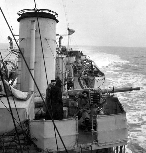

No, your picture shows the MKII Vickers-Terni. There were such on HMS:

According to my version, there should have been HV shells on the Vickers 40/40.

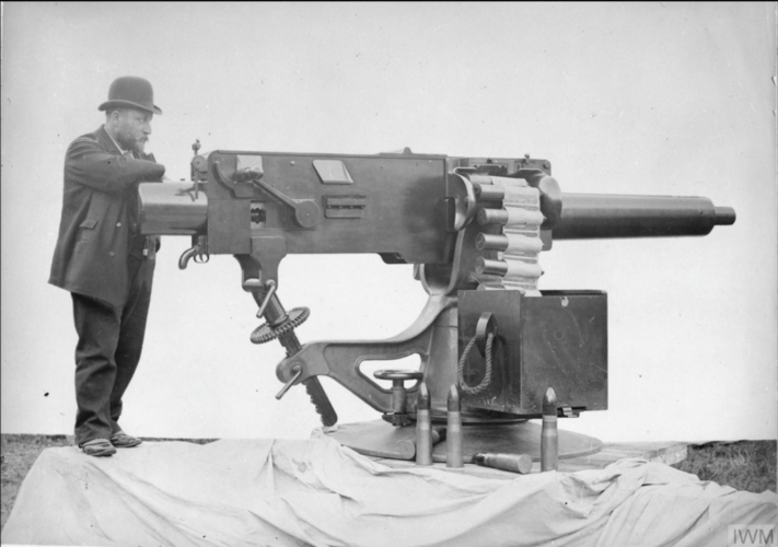

A little more info on this Maxim variant ?

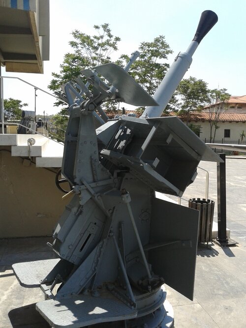

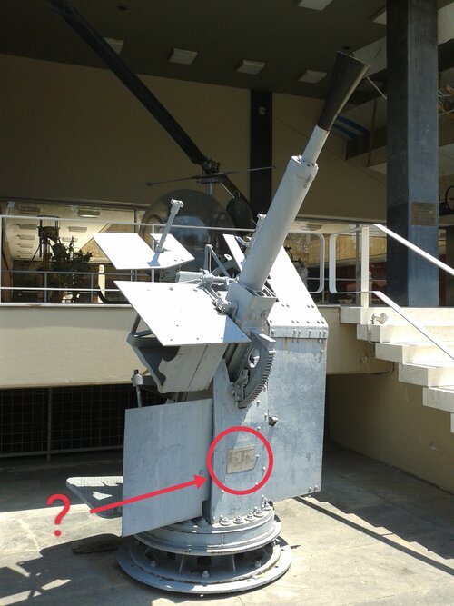

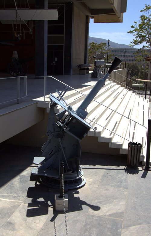

After I recognized the stairway in the picture of post #10 (it is the War museum in Athens, Polemikò Mouseio), I remembered I have a couple of pictures of that gun.

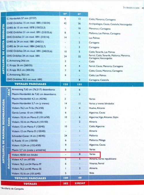

Here is what they write about them ("Vickers 40/40") in the book "ARTILLERÍA Y CARROS DE COMBATE EN LA GUERRA CIVIL ESPAÑOLA" (JOSÉ MARÍA MANRIQUE GARCÍA, LUCAS MOLINA FRANCO):
(Attach)
The authors claim that the submachine guns had a barrel length of 50 calibers!
Let me remind you that according to my comparative calculations, the Spanish pom-pom was 40 (!) calibers.
(Attach)

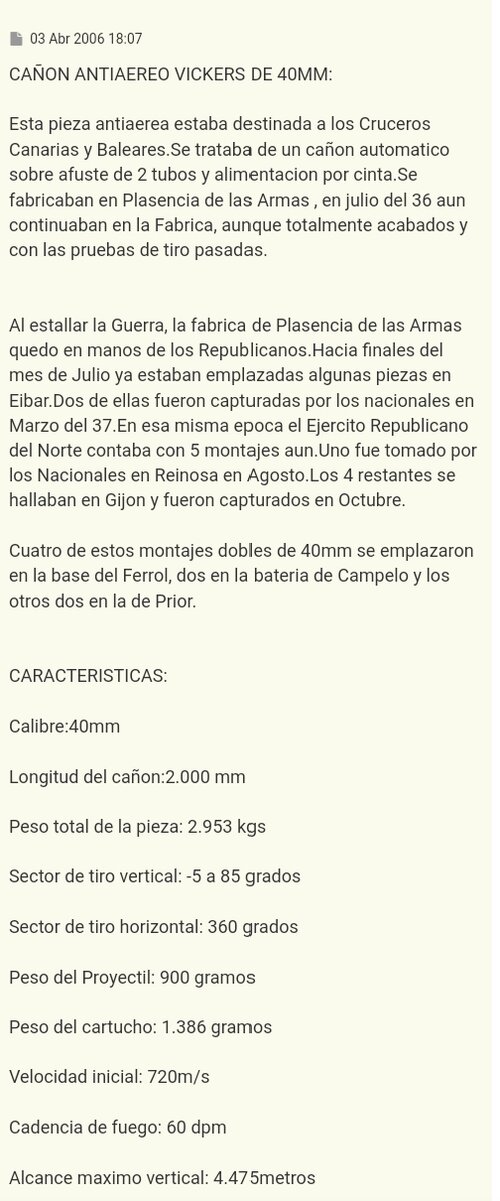

The post in El Gran Capitan forum clearly says the gun's barrel was 2000 mm long. So it was rather fifty-calibre than forty (it must have had 1600 mm long barrel).
All books (and especially those covering a very wide range of information) are liable to contain errors - yes, even mine!
I understand. Who does not investigate - he is not mistaken!

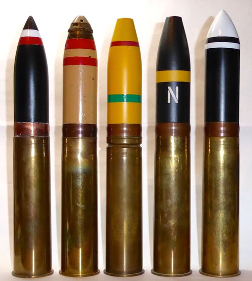

Do you have photos and plans of HV-type projectiles?
All I have is this group photo of 40 x 158R rounds.
From left to right: WW1 Common Pointed HE; LV round with settable time fuze in the nose; HV round with impact fuze; TP, and finally the AP for the Vickers Class S aircraft gun used in the Hurricane IID and IV.
....(it is the War museum in Athens, Polemikò Mouseio), I remembered I have a couple of pictures of that gun.

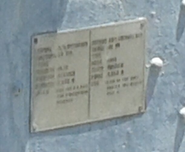

Hello!
Is it possible to see this board in a higher resolution?

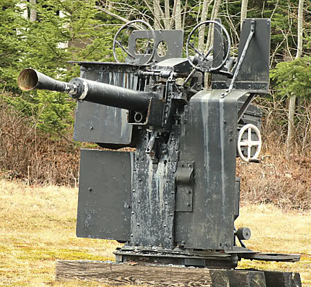

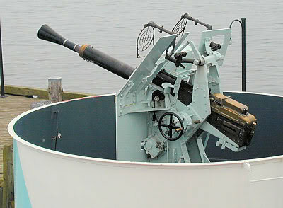

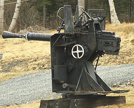

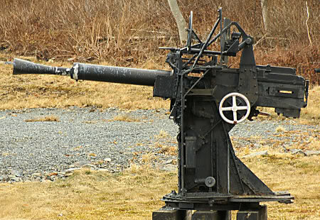

This may, or may NOT, be of relevance ;
I believe these are the Mark VII model, High Velocity, with manual elevation/traverse. The first image shows a gun in service on a Canadian naval vessel...post WWII but I don't know the year or ship. The other three photos show a monument-gun at, I think, Canadian Forces Base (CFB) Borden, in Ontario.
That's a new one to me - can you provide a source? As far as I know (Campbell's book, the NavWeaps website) all of the guns made from the start of the run-up to WW2 were Mark designated VIII, although made in many varieties, e.g. LV and HV, plus other differences in detail.
The only 2pdr Mk VII I am aware of is the quad mounting, but that used Mk VIII guns.

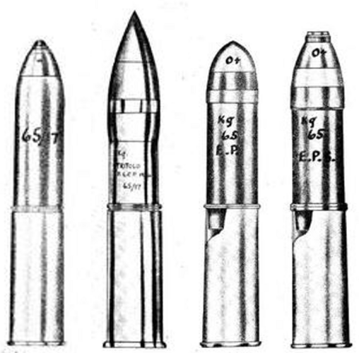

Any date on the photo? It does look a bit like a 2pdr pom-pom shell. But if not that, and Mr. Williams is right in the post above, maybe a 65mm Cannone da 65/17, which was Italian but used by Nationalist forces during the Spanish Civil War. Leftmost HE looks similar.
