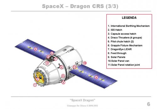

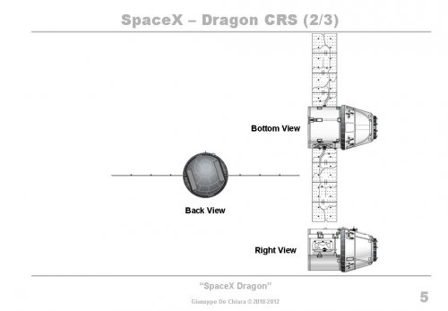

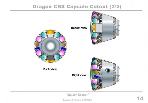

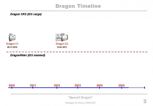

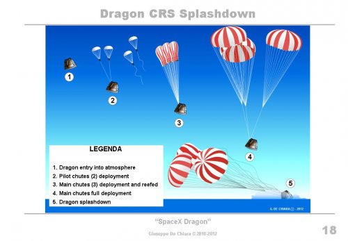

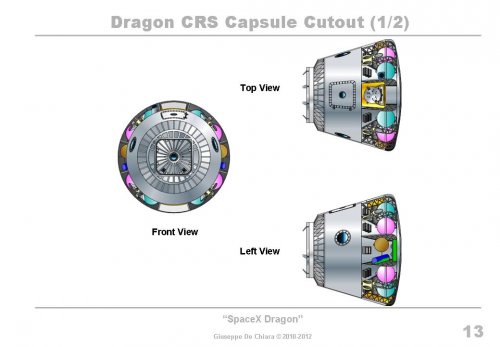

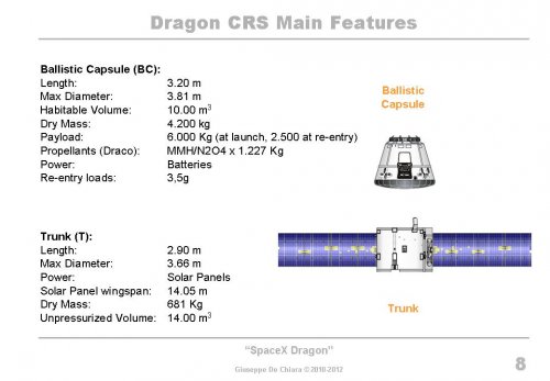

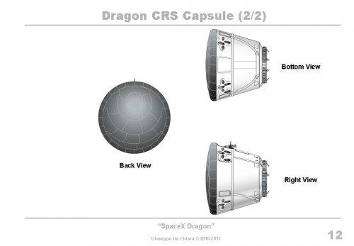

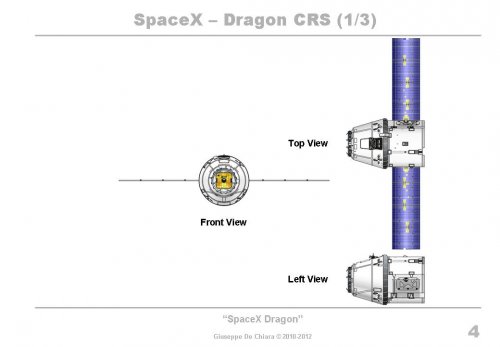

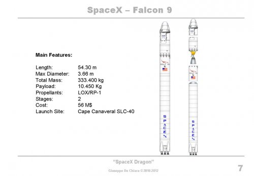

To celebrate the recent SpaceX tryunph, here it is a brief presentation about the matter.
Enjoy it!!

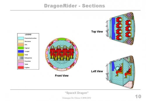

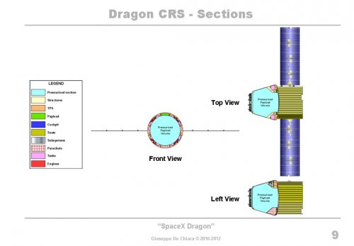

fantastic work, Archipeppe !
do i see right, the Dragon has no Service module in the traditional way ?
Thanks a lot Michel, you're always welcomed.
You are right, there is no "service module" in the sense that we tradionally know (Vostok(Voskhod, Gemini, Soyuz, Apollo CSM, Orion etc.) it is a mere connection element between capsule and Falcon 9 second stage.
It houses the solar panels, radiators (TBC), some minor system and unpressurized payload (like the HTV).
Everything is really important, from the thrusters to GNC, is contained within the capsule and returns to Earth.
It is clear that SpaceX people had, from since, in their mind the possibility to re-use the Dragon capsule, otherwise what purpose cold have to recover all those systems that represent a significative weight during the re-entry phase?

The idea to land a rocket powered space capsule comes from far, the first came up with such idea were Russians with their Zarya spacecraft (a sort of super-Soyuz) back in 1986.
During the 90's the unlucky DC-X proved that it was possible to land a spacecraft with modulable thrust rockets.
And now both SpaceX and RSC-Energia chose such approach to land both DragonRider and PTK-NP.
I think the parachute era is come to end.
