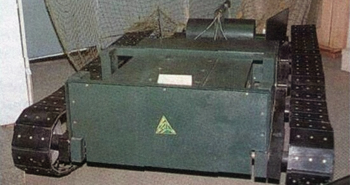

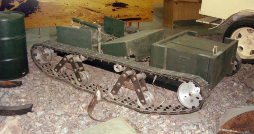

* Tracked mine ("Elektrotorpeda") ET-1-627 was deployed in limited numbers in 1942.
It was a wire-controlled tracked mine, somewhat similar to Vechicule Kegresse/Goliath, made on wooden frame from the small tractor parts. The electrical motor were used.
About 100 machines were build, and were used with some effect in 1942, mainly in Kerch (when they are credited for destroying nine German tanks), and near Leningrad. There were some ideas about further development, including the flamethrower-equipped variant for attacking trenches, but the disadvantages of the whole tracked mine concept were quickly realized. So, the project was cancelled after the initial series.

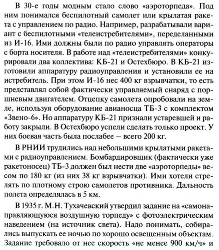

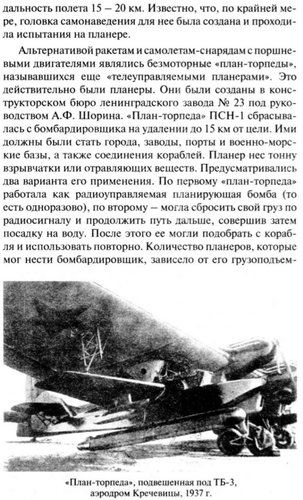

From "Stalin's superbombers", Kotelnikov:
"Telefighters" - radiocontrolled I-16. KB-21 tested I-16 with 400 kg of explosives. Ostehbyuro created only project, with 200 kg of explosives.
Radiocontrolled cruise missiles ("aerotorpedoes") for TB-3, project of RNII - full weight 180 kg, 38 kg of explosives, range to 5 km. Planned, use of two missiles from TB-3.
1935, "self-target air torpedo" with "photielectric" targeting (to light source), speed no less 900 kmph, range 15-20 km. Homing head tested on glider.

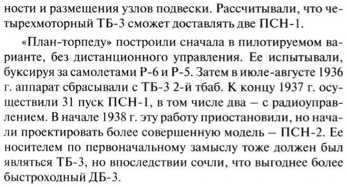

Radiocontrolled glider-torpedo PSN-1, range 15 km. Two programms - use like a bomb, or use like a mini-bomber, for later use. Planned, use on TB-3 two PSN-1. And, photo with PSN-1 on airbase. In 1936-37 31 launch completed (two - with radio control). In early 1938 works at PSN-1 was stopped, and started works with PSN-2, and, later, planned use on DB-3 bomber.

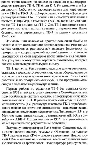

TMS-36 - one TB-3, comander, and two guided TB-1. Takeoff of TB-1 - with pilots who parachuted. Control system - "Dedal".
Range of control 15-20 km.
Plans - from airplane-bomb, to programmable bomber.
Works at TB-3, "minimum" - huge bomb, "maximum" - guided bomber.
Guided variant of "Mistel", KR-6 and TB-3-bomb. Load of TB-3 - 3.5 ton of explosives or chemical warfare agents, range 1200 km. Later, worked at variant with two TB-3, one comander and one airplane-bomb. Work was closed at 1938, but, later, restarted.
About "Teletanks" - projected huge variant, based on T-35.

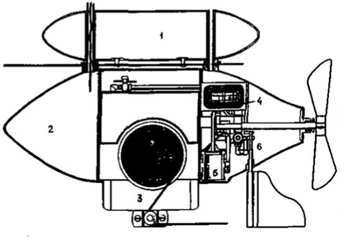

- Guided torpedo, engineer I. Nikolayev, 1876:
(you can see wire)
- Guided torpedo, artillerist Nemira, 1887 (only idea) - with wire

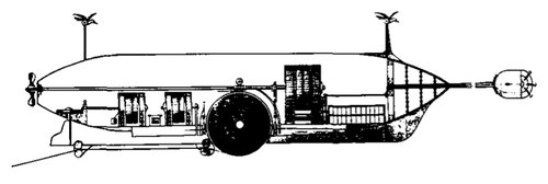

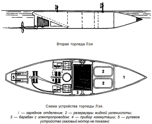

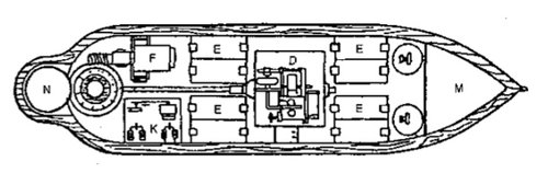

And (so you don't think that I came up with Russian guided weapons from 1876 to 1917), guided torpedoes, created by British (Brennan) and American (other) engineers, 1870-1900:

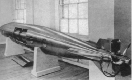

Ericsson, 1870:
Ericsson, 1873-78 (builted in 1873):

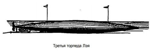

Lay, 1872-1880:
Smith, 1873 (wire):

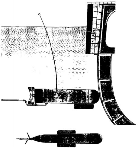

Brennan, 1874-1887:

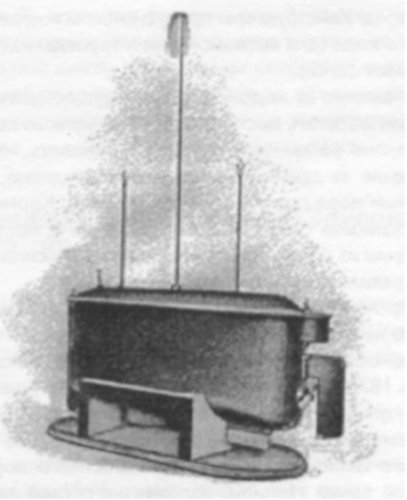

Tesla, 1897 (radio):

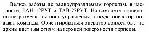

Doing some research for another topic, some time ago I found very little information about soviet radio controlled torpedoes, in a couple of Russian books and links (sorry, I am not absolutely fluent in Russian):
1) V. Kotelnikov "Giant aircraft of the USSR", 2009, p. 108 (Котельников, Самолеты-гиганты СССР).
Google translation: Work was underway on radio-controlled torpedoes, in particular, TAN-12RUT and TAV-27RUT. The control post was located on the torpedo bomber, from where the operator issued commands. The operator should navigate through the bright colored lights on the upper surface of the torpedo.
RUT (РУТ) means "
радиоуправляемой торпедой", radio controlled torpedo.

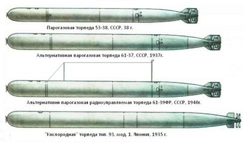

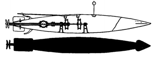

4) there is also the following image, without caption and reference, taken from
Охотники за линкорами 2. Легавые закрытых морей
The article is about alternative shipbuilding, but in the radio-controlled torpedo description the author says it was a real 1940 project:
Взяв прежние разработки Остехбюро по радиоуправлению торпедными катерами, они создали… радиоуправляемую торпеду! Торпеда шла под самой поверхностью воды, выставив наружу лишь рамочную приёмную антенну на двух тонких обтекаемых стойках, поднимающихся из корпуса после выхода торпеды из аппарата и фару-маячок, на верхушке задней стройке антенны, развернутую назад. Таким образом, выстрелив торпеду с предельной дальности и наблюдая по свечению фары её курс, оператор мог навести торпеду на цель при помощи радиоуправления со стопроцентной точностью. (Эта система отнюдь не моя выдумка, а вполне реальный советский довоенный проект).
Google translate: The article is about alternative shipbuilding, but in the radio-controlled torpedo description the author says it was a real 1940 projectTaking the previous developments of the Ostekhbyuro on radio control of torpedo boats, they created ... a radio-controlled torpedo! The torpedo went under the very surface of the water, exposing only the frame receiving antenna on two thin streamlined racks, rising from the hull after the torpedo exited the device and a headlamp-beacon, at the top of the rear antenna building, turned back. Thus, by firing a torpedo from its ultimate range and observing its course by the headlamps glow, the operator could aim the torpedo at the target using radio control with absolute accuracy. (This system is by no means my invention, but a very real Soviet pre-war project).
The radio controlled torpedo is the second from the bottom, type 61-39FR, with a radio aerial stretched between two masts (maybe the sketch is totally invented).
F = форсированная (boosted?), R = радиоуправляемая (radio controlled).
The author gives also some data:
Year: 1940
Types: 61-39F and 61-39FR
Diameter: 610 mm
Length: 8.1 m
Weight: 2500 kg
Warhead: 350 kg
Range/Speed: 10000/45, 5000/50 meters/knots
Note that in this case everything could be invented, image included.
So it seems that at least there were these RC torpedo projects:
1) TAN-12RUT: 450 mm (18 inch), derived from TAN-12 (derived from 45-12, a 450 mm torpedo designed in 1912), and TAV-27RUT: 533 mm (21 inch) derived from the high altitude, parachute dropped TAV-27 (derived from the 53-27 weapon of 1927). Tested in middle of '30?
2) RUT-45 (450 mm, is it TAN-12RUT?), Shark-1 and Shark-2 (??). Tested in 1934-36.
3) 24-inch with a charge of 320 kg and 27-inch with a charge of 500 kg, and RUT 18-inch (is it again TAN-12RUT?). Tested in ??
4) 61-39FP (610 mm, 24 inch) (fake?). Tested in 1940.
