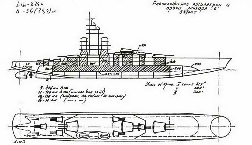

Am I assume it was the Battleship design from 1936 by Vladimir Polievktovits Kostenko?

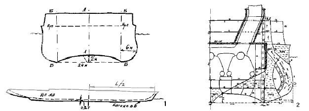

This drawing doesn't show it clearly but the under side is concave it was kind of a air lubricated hull like that proposed by thornycroft in the 1890s.
yes john i. thornycroft experimented with model boats with a hollow space between the bow and the stern that was filled with air to reduce drag .
Yeah it was slightly representing a catamaran or trimaran double or triple hull. With this hull the and bow which is somewhat similar to a shuttleboat, Kostenko wanted to achieve higher speeds because of the lower water resistance.
Her armour was unique as well as others mentioned the anti torpedo defence was unique and the inner belt armour was 355 and the deck armour was 200mm thick. The armoured citadel (compared to the ships 275m length) was only 150m
Also the propulsion system would be revolutionary at that time: 3x 50K shp Gas Turbines (Yes Gas Turbines!) which woudl give the ship 33-35knots speed!

V.P. Kostenko was one of the best Russian naval engineers, and he had been with battleship design since the Great War. Interestingly, I have seen another side elevation of this battleship showing a much more conventional hull layout. This one surely looks more interesting!

Are you referring my drawing of it?
http://tzoli.deviantart.com/art/Kostenko-1936-Battleship-179353988
Similar, but not this one! Wish I could remember - probably in some Russian website now gone...
Yours is just a re-interpretation, with a different, more conventional type hull type, but very interesting nevertheless: it reminds me of the Iowa class, or perhaps even Yamato...

Interesting. Myselff too did not able to find the drawing you referring to even by using Russian words in the google. Mostly I found the 1917 BB design
