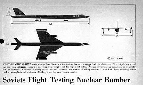

Wikipedia claims that the article concerning an atomic-powered Soviet bomber aircraft appearing in the December 1, 1958 issue of Aviation Week was a hoax. What is not explained in the Wikipedia entries is who perpetrated the hoax? Was this misinformation released by the KGB? Did a source, or sources, for the article lie to deliberately deceive the author or authors of the article? Or did Aviation Week print an article that it knew to be untrue?
http://aviationweek.com/blog/1958-false-starts-aviation-s-atomic-age
http://aviationweek.com/site-files/aviationweek.com/files/uploads/2014/10/1958-%20Soviet%20Nuclear%20Bomber.pdf
"Aviation Week itself caused a stir in the nuclear propulsion field when it reported in its Dec 1, 1958, edition on flight tests of what appeared to be a Soviet nuclear-powered aircraft. The report, on what later emerged to be an elaborate hoax, led to concerns that the U.S.S.R was pulling ahead of the U.S. and helped to extend funding in nuclear aircraft research for a few more years. The feature also contained a very detailed timeline of associated nuclear aircraft plans in the U.S. and foreshadowed actual flights of a modified Tupolev Tu-95 equipped with a reactor in the early 1960s. The Soviet research in nuclear-powered aircraft, like that in the U.S., effectively ended within a few years as ICBM’s rendered the concept obsolete."
My understanding of the meaning of the word hoax is "a deliberately fabricated falsehood made to masquerade as truth." I don't understand how Editor Robert Hotz printing rumors and information believed to be true concerning the Myasishchev M-50 is considered a hoax. Why did author Guy Norris in his article "1958: False Starts For Aviation’s ‘Atomic Age’" use the the phrase "elaborate hoax"? Did Robert Hotz know that the information in the article was untrue?

It has been suggested that the hoax was played on AvWeek by someone in the USAF fed up with their leaks.

The Aviation Week article about the alleged Soviet nuclear-powered plane was fabricated by someone in the Atomic Energy Commission and ANP program to renew research into nuclear-powered plane technology (http://www.megazone.org/ANP/politics.shtml). Remember that the Myasishchev Design Bureau was working on a nuclear-powered version of the M-50 as the M-60, so it's possible that the US mistakenly assumed that the M-50 was nuclear-powered.
