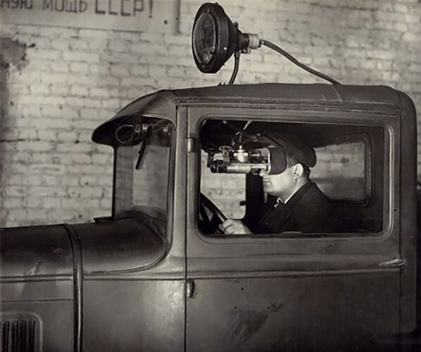

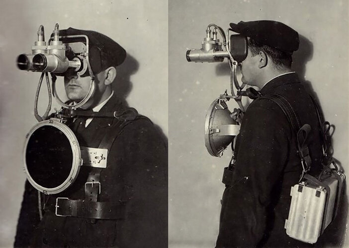

Resurrecting another ancient thread, forgive me.
  • All-Union Electrical Technical Institute C-1 Image Converter and Infrared Illuminator (1).jpg
  • All-Union Electrical Technical Institute C-1 Image Converter and Infrared Illuminator (2).jpg
  • All-Union Electrical Technical Institute C-1 Image Converter and Infrared Illuminator (3).jpg
