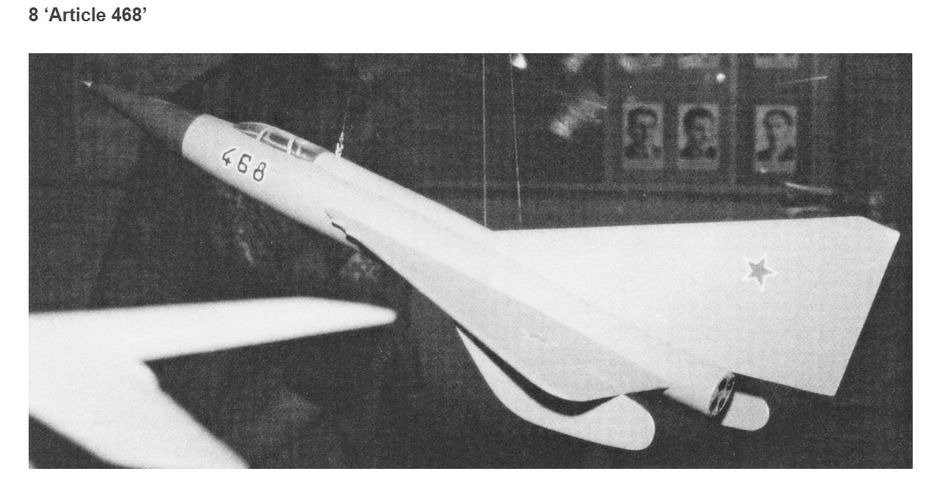

Except for the project number, this sounds exactly like the Type 468 which was a single seat, delta winged interceptor powered by four rocket motors and designed by German engineers at OKB-2 at Podberez'ye in 1949. A full size model for gliding and wind tunnel tests was built in 1950 but was never flown because the OKB was suddenly closed in June 1951. Full details are in Tony Buttler's "Soviet Secret Projects - Fighters"
Thanks a lot McGreig ;)
I toke a look at Soviet Secret Projects and that's it!. The Type 468 was incorrectly identified with the number 478 by occidental press in 1956.

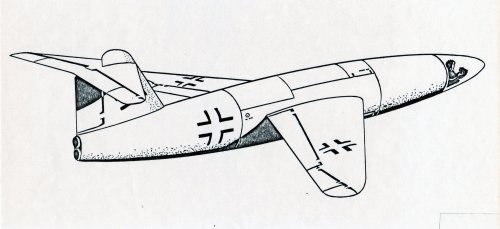

What is this aircraft ?.

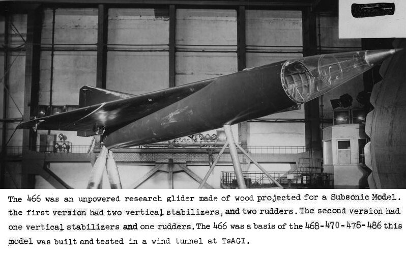

Projects Type "466-468-486" Other name DFS-468-486
By now the OKB-2’s team leader Hans Rossing had working alongside him a Russian counterpart called A.Ya.Bereznjak (afterwards S.M.Alexeev), together with a well-known engineer from the former Heinkel company called Siegfried Gunter.
OKB-2’s design team therefore began looking at new ideas for an interceptor and the result was the single-seat Type 468 started in1949.
This was a delta-winged aircraft that had 60 degrees of sweep on the leading edge, a huge single
swept fin and two more fins on the underside of the wing that might possibly have doubled as skids for landing. (on 468), and one fin on the underside of fuselage (on 486)
The glider, known as the Type 466, was expected to reach a maximum speed of 500km/h (311 mph) and in appearance it looked very similar to the 468. It was built in 1950 and tested in the full-size wind tunnel operated by TsAGI, but it was never flown because very suddenly, in June
1951, OKB-2 was closed and disbanded. Work on the 468; 486 was brought to an end many of the Bureau’s engineers were transferred to rocket work.
from: T.Buttler & Ye.Gordon "Soviet Secret Projects fighters since 1945" pp.112-113

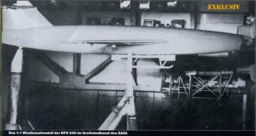

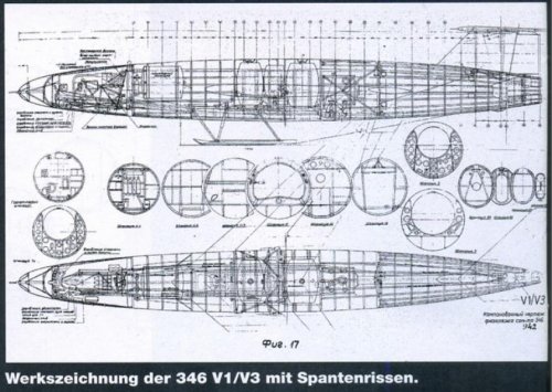

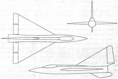

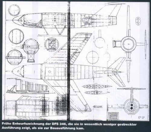

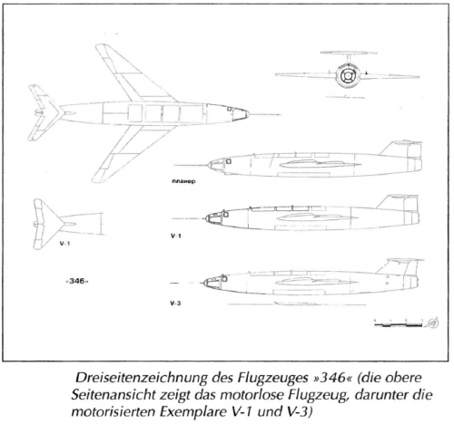

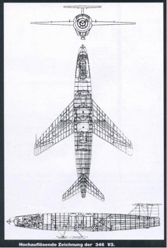

instead off open new topic,I can add the DFS-346 here,and from article about DFS-346
in Russian,here is some drawings one Model.
Flugzeug Classic 9/2003

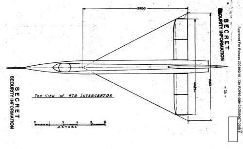

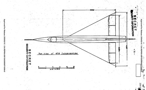

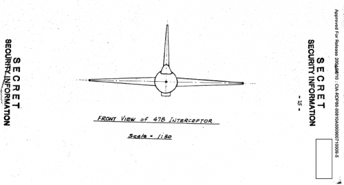

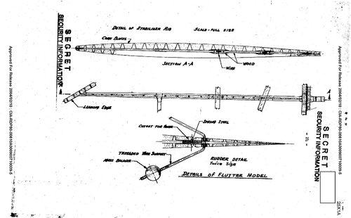

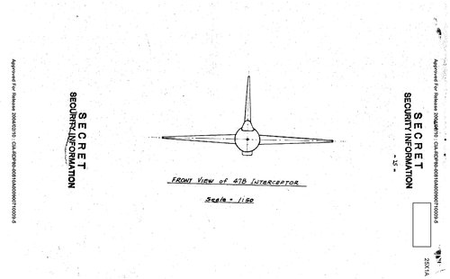

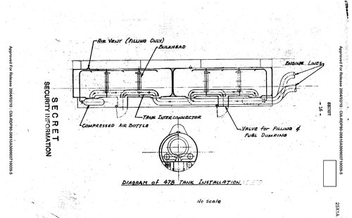

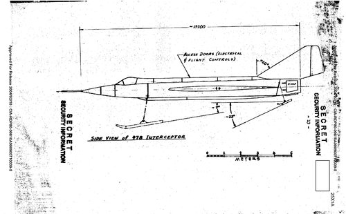

Hi all,
maybe some of you already know this "Project 478" developed from a German engineering group in Russia just after the end of WW2, but it is interesting how the drawings at the end of the report are so detailed.
Regards,
  • DEVELOPMENT PROJECT AT ZAVOD NO. 1 IN PODBEREZYE - 1953.pdf

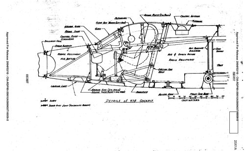

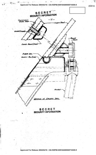

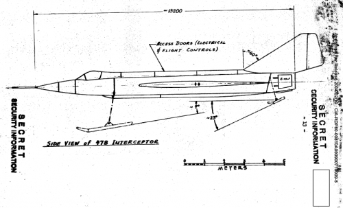

Great find Temistocle,
it was DFS-478,and we can put it here.

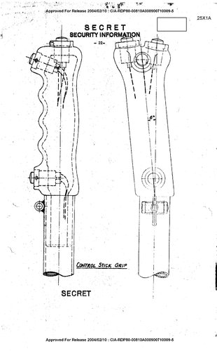

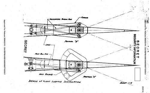

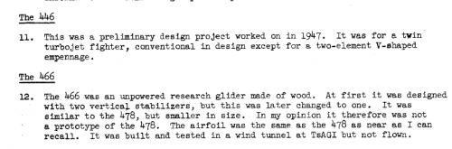

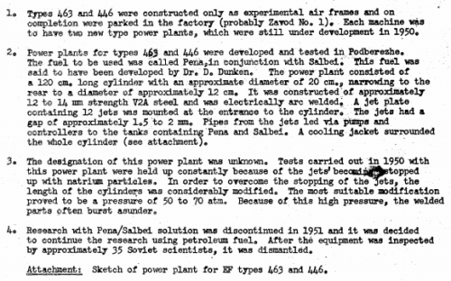

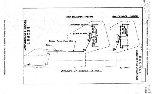

and here is a more Info about DFS-446 & DFS-466,also the new one DFS-463
https://www.cia.gov/library/readingroom/docs/CIA-RDP80-00810A000900710009-5.pdf
https://www.cia.gov/library/readingroom/docs/CIA-RDP82-00457R013000360002-0.pdf

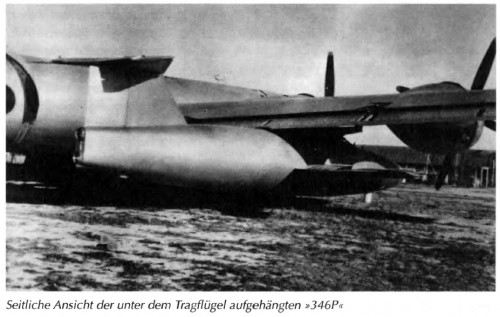

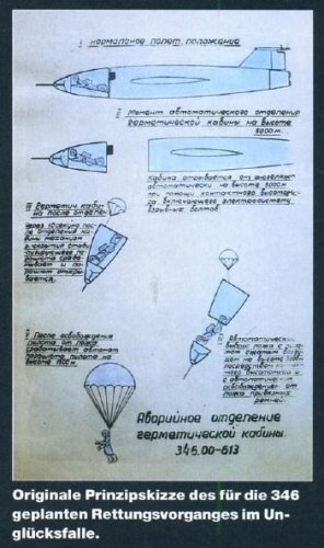

From; Deutsche Spuren in der Sowjetischen Luftfahrtgeschichte

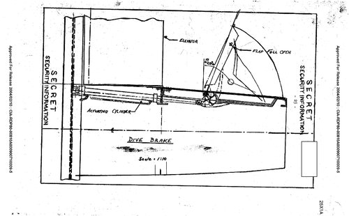

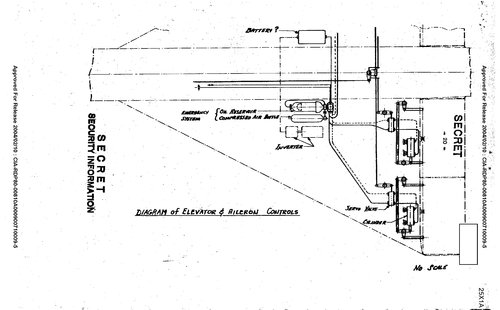

Hi all,
Regards,
I haven't read this document until now. It's very interesting.
