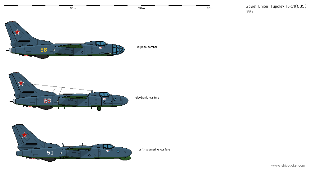

For support aircraft, perhaps the Tu-91 would be still useful for ASW and AEW variants like Alize or Gannet? Though for the 1960s to equip the bigger AVL perhaps they would build something like a turboprop E-1 (with two Tu-91 engines), or even an E-2 like plane (sort-of like a much earlier Yak-44)?

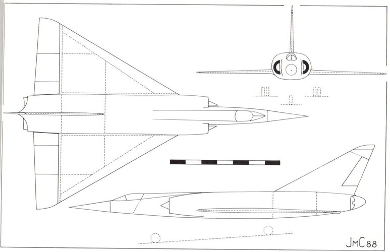

I was looking at some french projects in about that timeframe and it seems they had no qualms about designing highly swept deltas for carrier use, there were Durandal and Mirage-III carrier projects. And iirc, they even planned to operate the large Mirage-IV off the planned PA-58? So it seems there is no big issue in flying and landing highly swept deltas off a carrier? Are there examples of a tailed delta supersonic carrier project?(the A-4 does not really qualify, it's neither supersonic nor highly swept)
Mirage IV M, navy heavy fitghter (1956-57 project):
-Length : 19,35 m
-Wingspan : 11,75 m
-Wing area : 70 m²
-empty weight ("equipped") : 9 585 kgs
-gross weight : 16 500 kgs
-powerplant : 2x6000 kgp (Atar 9)
Cancelled after cancellation of PA-58
Source : Les avions de combat français 1944-1960, volume 2, Jean Cuny, Docavia Larivière publishing, 1988, pages 112-113.

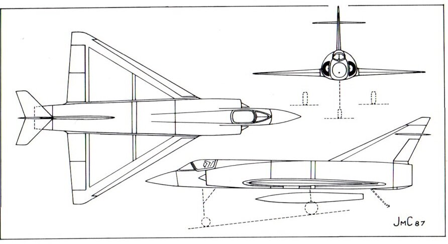

Mirage V, navy fighter (1957 project):
-Length : 15,75 m
-Wingspan : 9,40 m
-Wing area : 45 m²
-empty weigth : 6 554 kgs
-grosse weigth : 15 400 kgs
-powerplant : 8500 kgp (Super Atar)
Source : Les avions de combat français 1944-1960, volume 1, Jean Cuny, Docavia Larivière publishing, 1988, page 287.

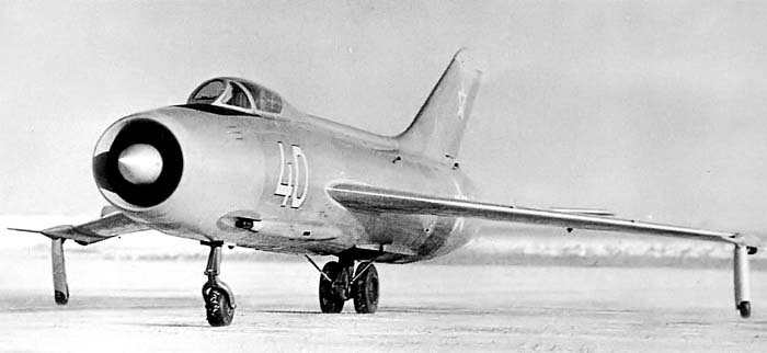

Having looked at the soviet technological level in this period, apart from highly swept and delta wings, they were also working on moderate sweep wings, suich as on Ye-155 and Sukhoi S-6. As far as carrier operations are concerned, a moderate sweep wing with LE devices, blown and double slotted flaps etc. is the most suitable isn't it?
So in typical soviet fashion, they could take a suitably downscaled Ye-155 wing modified as above, maybe even dog-toothed like on F-8, and put it on MiG-21, or Ye-8, or side-intakes Ye-8M etc. Or Sukhoi could take a downscaled S-6 wing and put in on a Su-15 airframe, or P-2 etc. etc. (probably the AL-7F can't be trusted for carrier use).
Or even more extreme, suitably downscaled single or twin engined mini Ye-155 (made from aluminium, for Mach 2 only) or mini S-6 as carrier based interceptors? Or in american terms, a sort of mini A-5 (which apparently did provide some inspiration for Ye-155 and possibly S-6). Though these would be new designs with the attendant extra workload.
