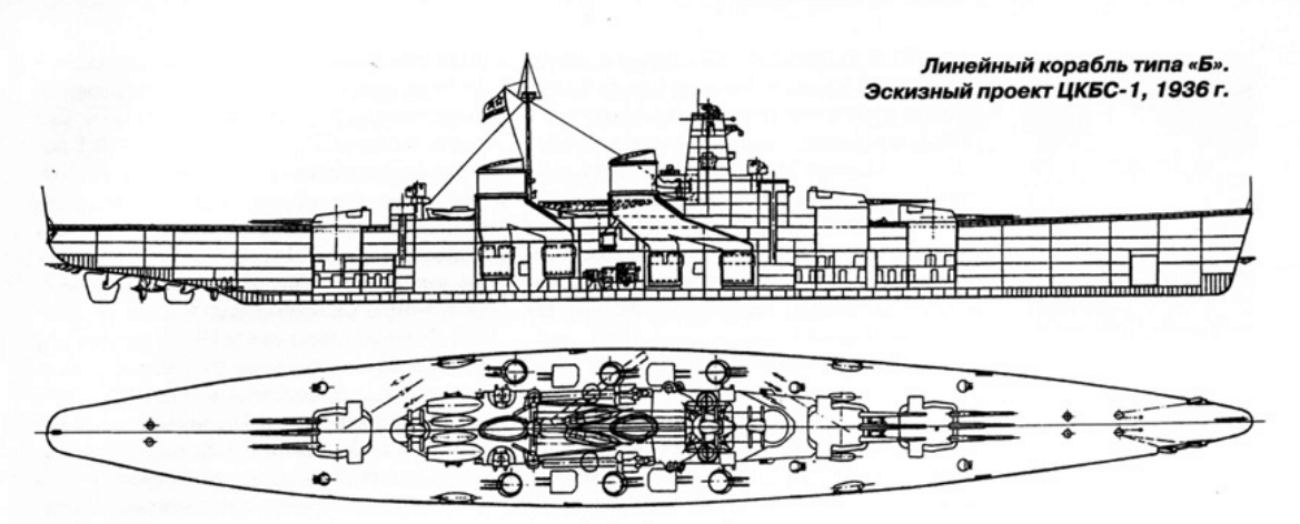

The TSKB-1 proposal:
View: https://i.imgur.com/rQQr5vQ.png
