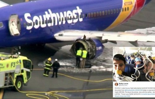

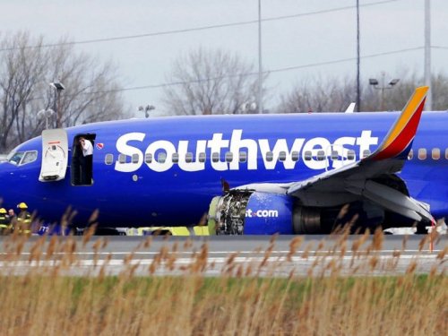

Southwest airlines fan blade failure and containment ring failure, one businesswoman dead after being sucked half way out of the aircraft at 30k ft.

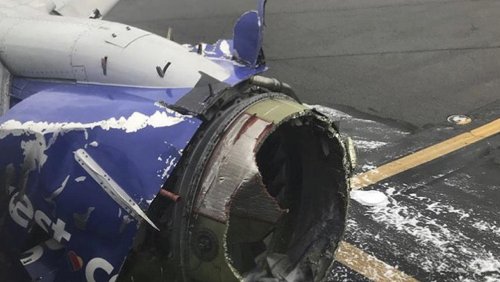

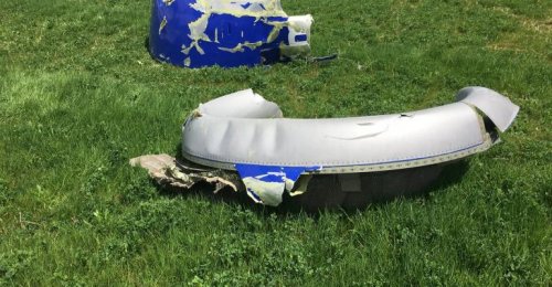

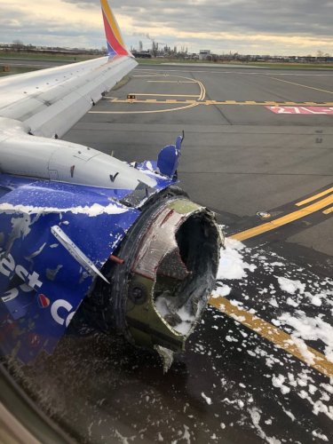

Let's be careful with terminology. There's no evidence that this was an uncontained failure - the containment ring looks intact and the NTSB appears to have pieces of the fan blade. They know it broke in two places, which implies that they have at least one part in addition to the stub that remained in the fan disk. This suggests to me that at least part of the blade was recovered, possibly from inside the engine.
Several eye-witness reports suggest there was a noticeable delay between the initial bang (fan blade failure) and a second event that broke the window. My hunch would be that there was a contained failure that led to an unbalance/vibration condition that caused the cowl to fail catastrophically. Something from the cowl is what hit the fuselage and broke the window, leading to the fatality.
Even more that the position of the window that was broken suggests that it was a flying debris instead of a purely ballistic one (such as would be a ruptured blade).

NTSB Chairman Robert Sumwalt said "As the aircraft was climbing through about 32,500 feet, the engine parameters, both RPM indicators on the left engine went down to zero, oil pressure went down to zero, and the engine vibration increased significantly on the left engine," he said.
Shortly thereafter, the cabin altitude warning horn was activated, indicating that the cabin altitude was "going down to about 14,000 feet," said Sumwalt. The aircraft then began an uncommanded left roll at about 41 degrees of bank angle, compared to the normal 20 to 25 degrees of bank that is typical when flying a commercial airliner, such as the 737, according to Sumwalt.
41 deg bank and roll to left is pretty significant, that probably when the debris hit the passenger window, as mentioned above there was a delay when the window was hit after the failure.
