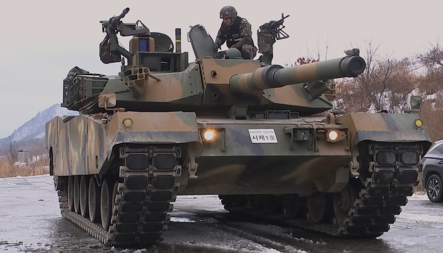

A Korean source on the K1 upgrade
The Army Test Evaluation Team is currently conducting tests over the past 8 months to assess the performance of the K1E1 tank and its upgraded equipment in extreme cold conditions, considering potential field situations.
The K1E1 tank performance improvement project is a research and development initiative investing 27.5 billion won from 2021 to 2025 to enhance the performance of the currently deployed K1/K1E1 tanks in the military. The entire project duration extends until 2038, with the K1E1 being upgraded to the K1E2 level.
The performance improvement elements for the K1E1 tank upgrade (K1E2) include:
  1. Replacement with a new gunner's sight.
  2. Installation of positive pressure equipment for enhanced NBC protection.
  3. Installation of a cooling device.
  4. Installation of an Auxiliary Power Unit (APU).
After testing the prototype, the upgraded version of the K1E1 tank, designated as K1E2, is scheduled to be sequentially upgraded from K1/K1E1 tanks through a retrofit process starting in 2026.
Regrettably, the list does not include equipment to enhance defense against the strengthening North Korean tank forces and improve crew survivability. The Remote Controlled Weapon Station (RCWS) equipment is mentioned in Defense News as being installed during the performance upgrade of the K1A2 tank and the introduction of the new K3 tank

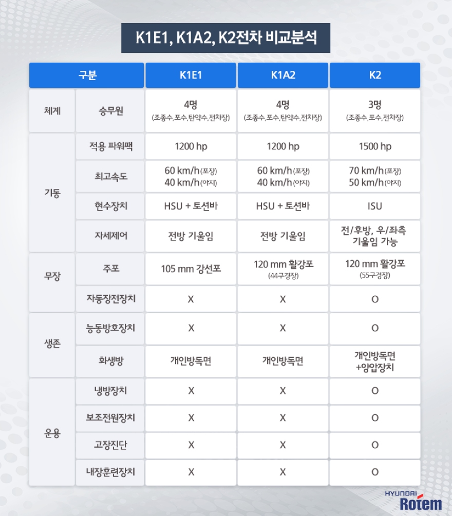

This chart looks like its official and it would confirm that the E1 has the 105mm gun, although the A1 has the 120
