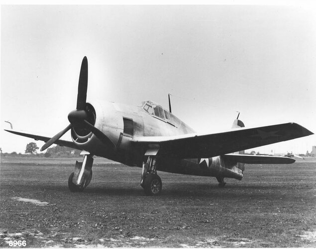

I am not aware of any fighters using this engine. Any reason?
But then they switched. Bad experience?
Well if you do some basic investigation yourself you will see that the more powerful R-2800 was also available so they went with it to produce a better platform. There was nothing fundamentally wrong with the R-2600 and indeed 50,000+ were produced.
Some engines are better suited for bombers, some for fighters. For instance, Cyclone powered Mohawks had issues during maneuvers while not having problems in B-17s
